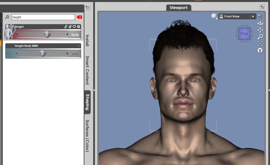

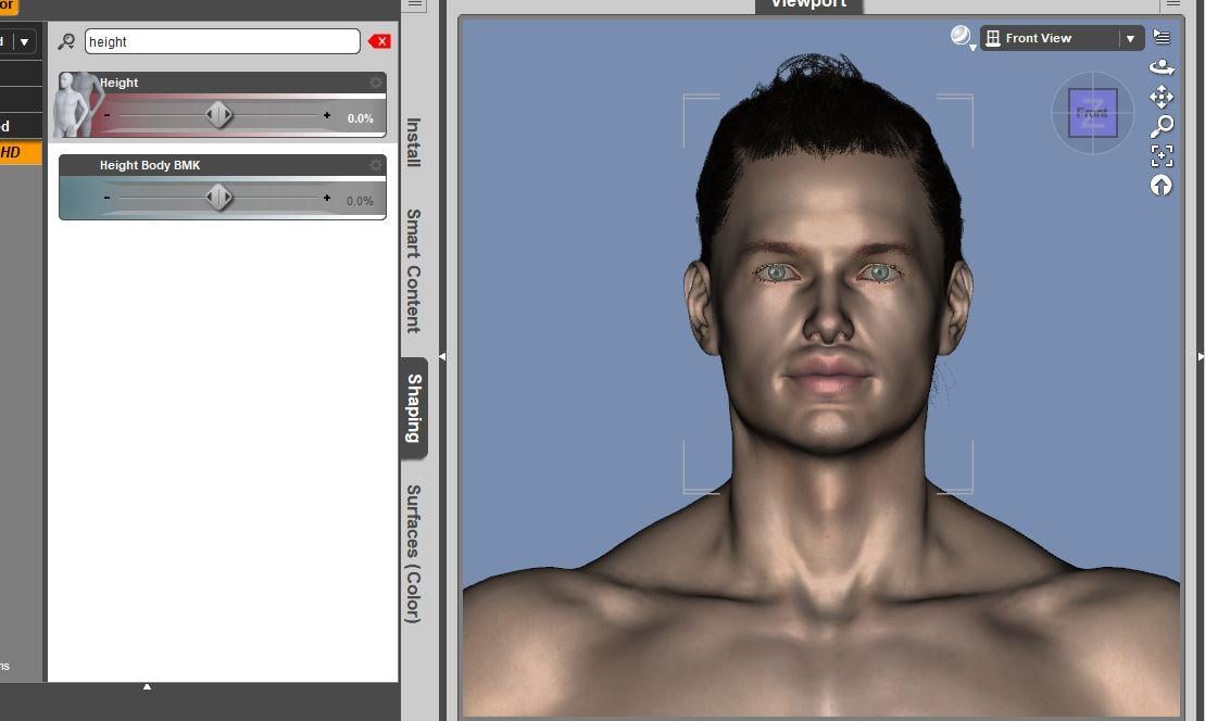

Can someone test this hair if you have it. It is fitting pretty badly, sometimes perched high up on the head, and sometimes pushed far back. It is very strange.

  • The problem I discovered wtih the hair, is if you use the height morph on the figure it is distorting the hair placement. So on one character that is tall, it sucks it down, and on my character who is short, it flies up. If you zero out the height- it seems to fit.

    See, here is with the height dial dialed in, and without. When its on, the scalp flies up.
    1075 x 656 - 69K
    1109 x 664 - 73K
    If you conform/fit the hair like you normally would, then change the parenting from the figure in general to the head then scaling and posing work fine....including height.
