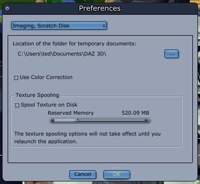

  • FenricFenric Posts: 351
    When you say 'texture mapping', I assume you mean the Texture Spooling option, which should always be turned off for 64-bit systems?
    I wonder if Metaball calculations are single-threaded? That's about what I would expect for CPU usage if part of the render was locked to a single thread.
    edited December 2013
    If you don't, then you will see that Carara very rarely manages to get your processor up to 100%, particularly if you have any of the Global Illumination options activated (skylight, ambient occlusion, caustice, or full indirect - doesn't matter what)
    Running a performance monitor will show that Carrara spends an inordinate amount of time in completely pointless Disk I/O

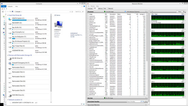

  • dean_cefd567820dean_cefd567820 Posts: 0
    Yes I mistyped, "Spooling", and it is off.
    I cropped down a screen grab to show you the engine monitor.
    You can see that it is just not working very hard. Something bottle necking. And I am out of ideas.
    If Carrara wanted more, it isn't asking
    1999 x 1131 - 1M
  • DartanbeckDartanbeck Posts: 21,988
    I misunderstood the issue for sure. All eight of mine jam straight up to 100% during renders. I have 16GB RAM and have never come close to maxing that out in Carrara - well... while I was checking, anyways.
