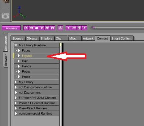

  • If your DIM is set up properly with Carrara, you shouldn't have to add other folders.  V4 should load and work fine.
    Are you talking about the content tab, or do you mean the smart content tab?  In the regular content tab, V4.2 shows up under figures>Daz people.

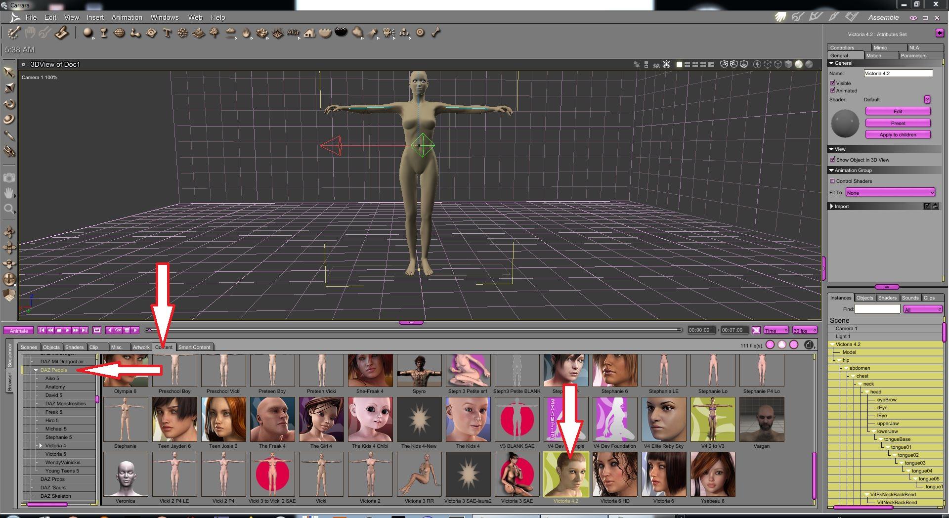

  • DiomedeDiomede Posts: 15,464
    When Victoria 4 was released years ago, the Daz genesis duf format did not exist.  Victoria 4 was released in Poser "cr2" format in the traditional Poser Runtime file structure.  I installed Daz Victoria 4 to my computer using DIM.  I did name my host folder a custom name (Stuff for Studio), but other than that I allowed DIM to install everything to its default location.  If you did also, than the relative locations should be the same (substitute "My Daz Library" for the places where I have "Stuff for Studio")
    The V4.2 figure is found in the Runtime \ Figure \ Daz People    subfolder
    The morphs for V4.2 have to be applied.  They can be found in the Runtime \ Poses \ Daz's Victoria 4    subfolder.
    My Carrara came with some Carara-optimized shaders for V4.  Not sure that came with all editions of C8.5, but probably so.  My shaders were found under the shader tab in the Skin subfolder.

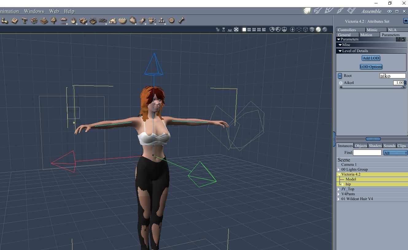

    - I started a new Carrara scene.
    - I loaded V4 from my Runtime \ Library \ Figures \ Daz People subfolder.   ( I also applied a Carrara skin shader and loaded some hair but ignore that for now).
    - From the Runtime \ Library \ Poses \ Daz's Victoria 4 \ Morph Injections subfolder, I dragged and dropped the + injection files for Basic, Morph++, Elite, and Aiko 4 on to my V4 figure to load them.

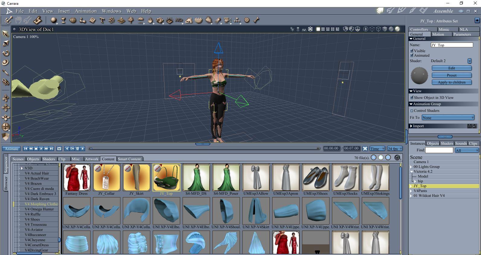

    - From my Figures \ V4 Morphing Clothing subfolder, I loaded the JYTop and the V4Pants.  Please load those specific ones for his demonstration.
    *** I loaded these two clothing items independently.  For now, I did NOT drag and drop them on V4 or double click them with V4 selected.  They are NOT fitted to V4 yet ***

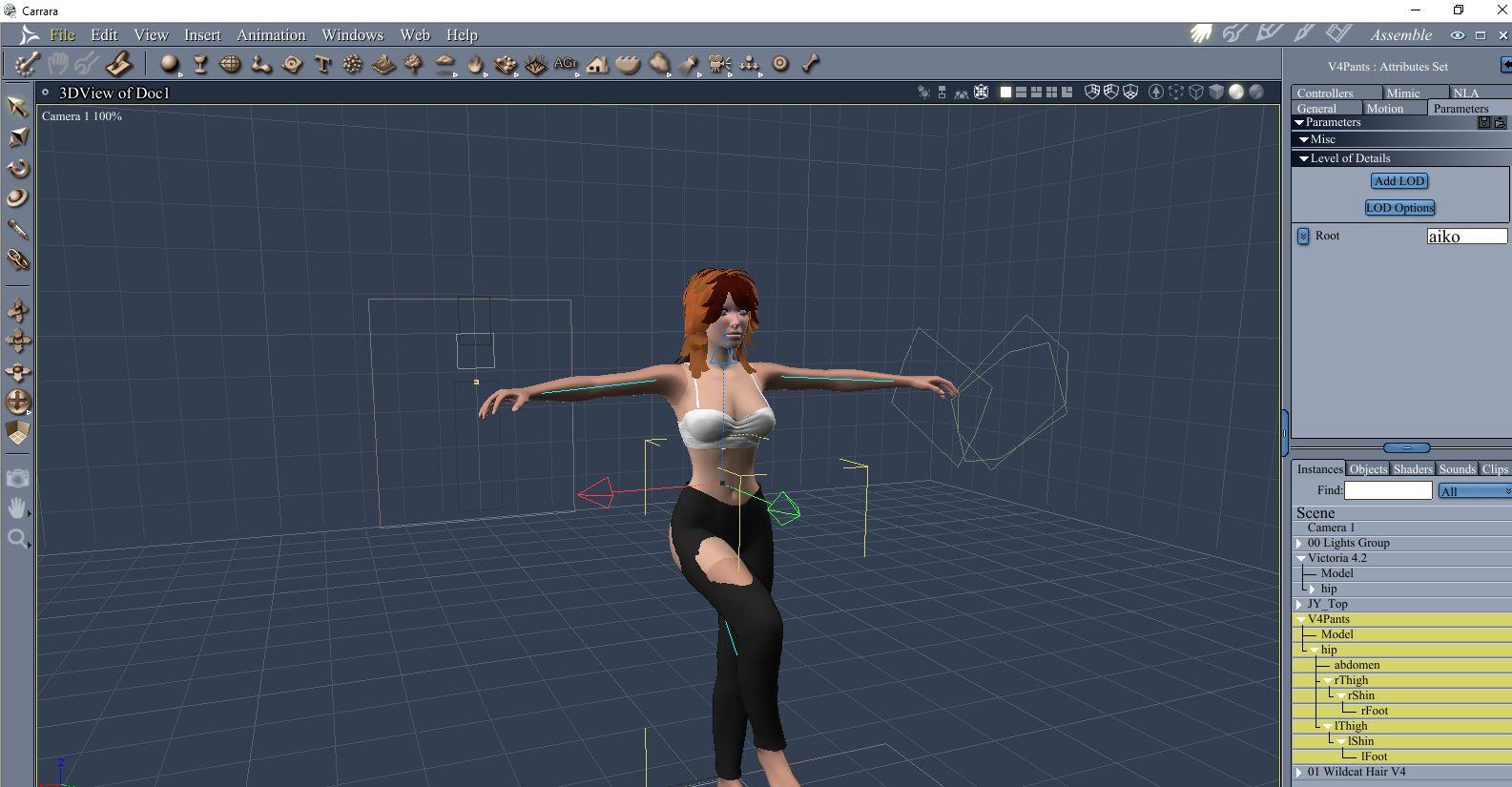

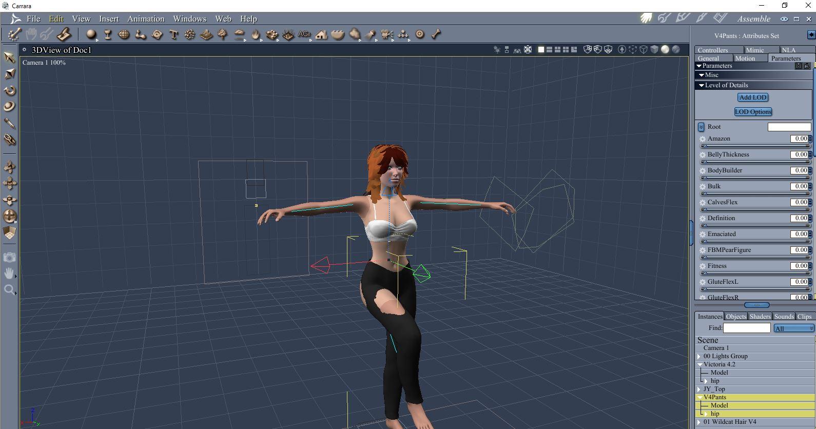

    - With V4 selected, I went to the parameters tab to see a list of morphs.  I dialed Aiko 4 to 1.  I also selected the V4 right thigh and rotated the thigh forward and up.  You can see that neither the top nor the pants look correct.

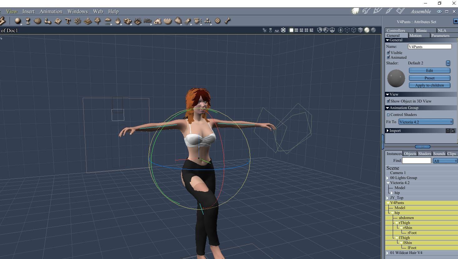

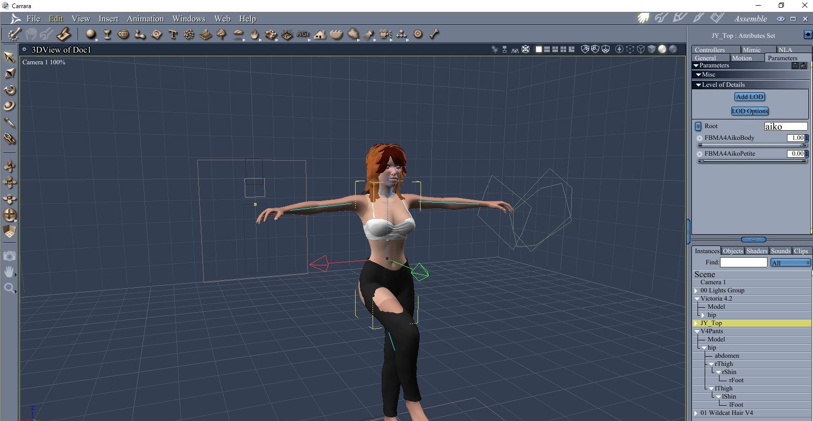

    - I selected the top and used fit to V4, and selected the pants and used fit to V4.  See that the top now fits fine.  The pants conform to the pose but do not seem to fit the shape.
    - Looking closely at the JYTTop figure parameters, notice it as an Aiko4 morph and it has automatically dialed to 1 to match the V4 figure morph.
    - In contrast to the top, choosing the pants parameters, there is no Aiko 4 morph present in the pants.  That is why the shape looks wrong (and also a tweak for the thigh bend to a lesser degree).

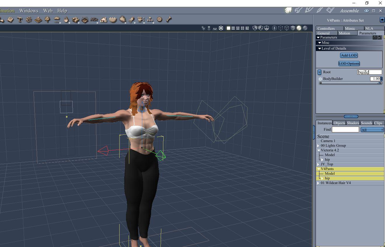

    - Looking more closely at the pants parameters, there are a whole bunch of morphs present, jut not Aiko 4.

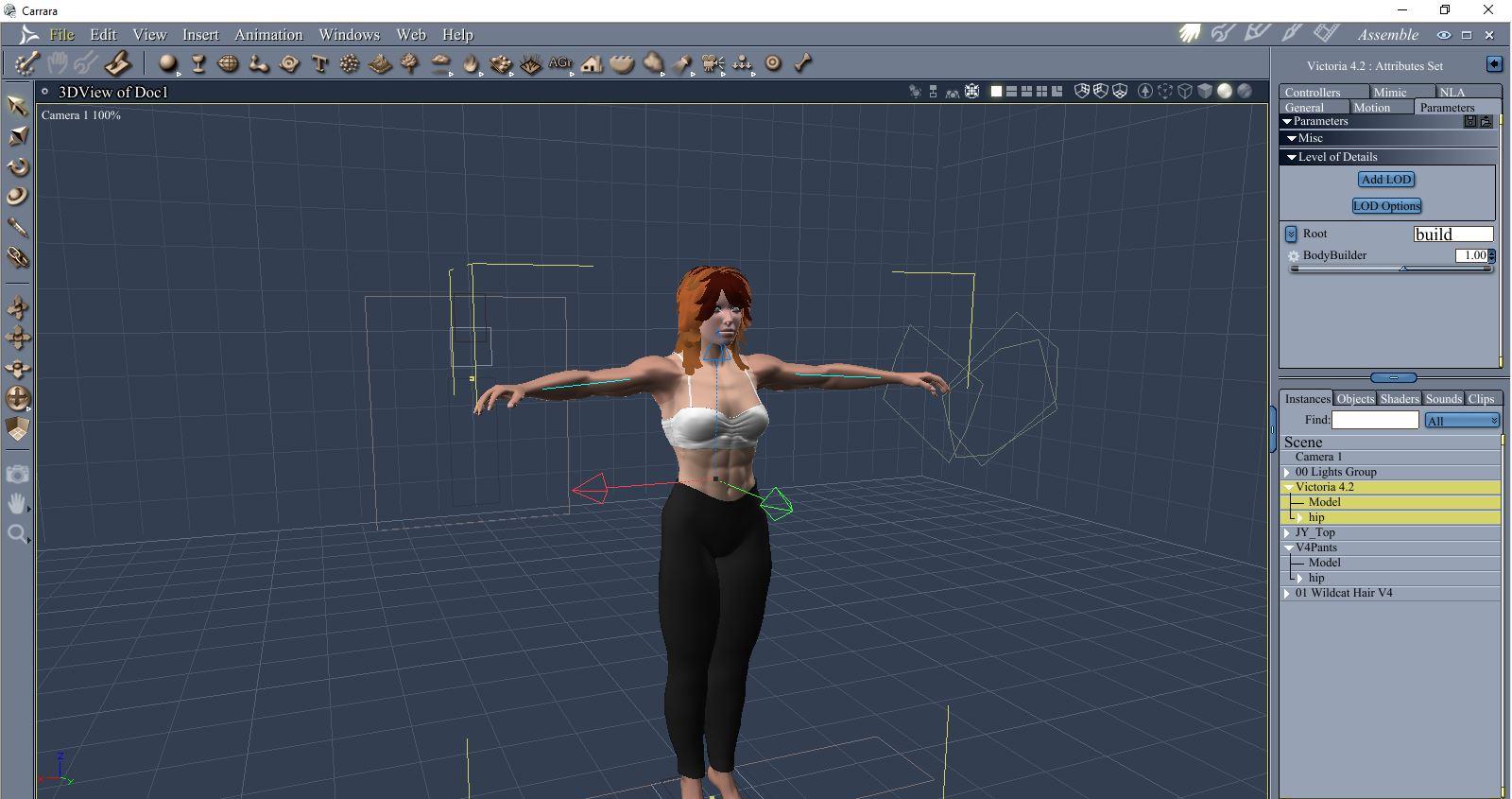

    - To test, I selected V4 again, dialed Aiko 4 morph back to 0, but dialed bodybuilder up to 1.
    - The pants match the V4 morph because there IS a bodybuilder morph in the pants.
    *** Although it appears that the V4 morphing pants didn't work with my first test of V4, that wasn't true.  The pants don't happen to have Aiko4 morphs.  The JYTop does.
