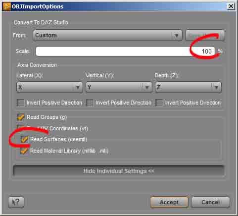

First of all: you have to understand that 3D models in obj format come from a different 'platform'
So it is very common that the scale is not similar to the DAZ standard.
Try import with scale 4000% instead of 100%.
And for the materials: it sometimes helps unticking the Read Surfaces box.
Then your object will pop up with no colors, but at least it is visible.
You can also open the material file in Notepad to check if there are no references to images in wrong folders.
edit: I re-read your post, just import it with scale let's say 10%.
