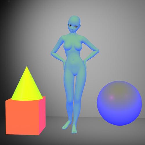

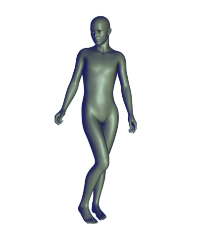

Been having some fun relearning the Shader Builder (call it my programming background, but it appeals to me more than the Shader Mixer does). I managed to recreate the Gooch shader from the Renderman Companion book / website.
1024 x 1024 - 34K
    That's a good one to work with.
    It's a pretty good code that isn't too difficult to 'translate' into Shader Builder.

    Nice. :) I think that looks like Simple Plastic, but I could be wrong.

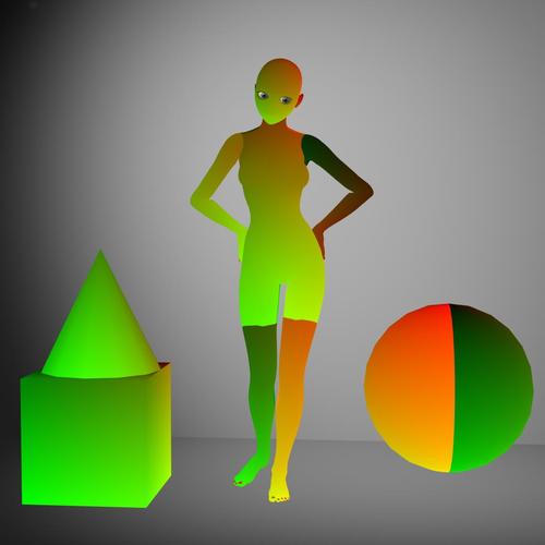

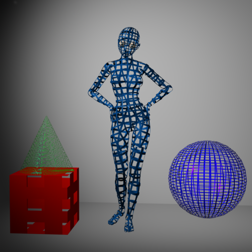

    I've also managed to screen her now. :p Added some primitive objects to the scene too so I could see how the shaders look on models with less complex UV maps.
    1024 x 1024 - 1M

    It's the gooch...I just played around with the settings a bit, no presets for it.
    I also did the screen one.

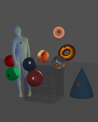

    Here's a bunch of the ones I did...
    A Cook-torr
    B Fresnel
    C Gooch
    D Plastic,
    E Plastic (this one has a variable 'texture')
    F Cook-torr with diffuse texture map
    G 'Fake' Rim Light, with variable ring
    H Ashikhmin
    I Glass wit fresnel and reflections
    J 'Wireframe'/Cage
    K Carpaint
    The light in the scene is the envlight2 from 3Delight...
    800 x 1000 - 43K

  • almahiedraalmahiedra Posts: 1,374
    For Aiko's connected shader behaivor you can change "current" space to "NDC" space.

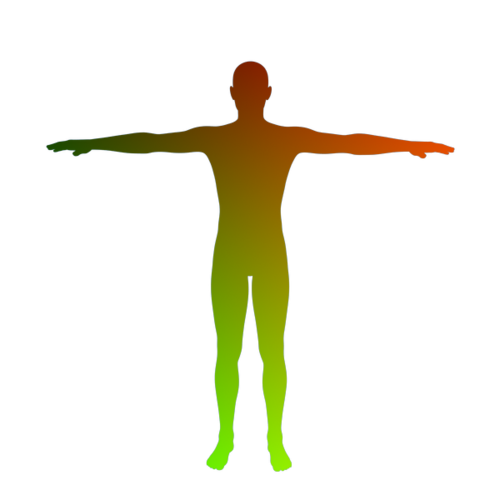

    I read at least 5 books in RSL, only one speak about NDC.
    The transform didn't work out as hoped. :( I tried several options for the "to space". Nothing helped much. I put the results of my test up on my blog.
    Project: Renderman Shaders
    edited January 2014
    It is my code and result in G2M
    point Pp = transform("NDC",P);
    Ci = color(xcomp(Pp),ycomp(Pp),0);
    edit: to erase useless lines
    600 x 600 - 54K
    Post edited by almahiedra on

    Interesting gilkshe. I'll have to see tonight when I get home if it is a model issue. I've been using Aiko 4. It could just be that her UV mapping doesn't lend itself well to this sort of shader. My straight ShowST example shows plenty of seams. Granted, my ShowST shader doesn't transform the coordinates. Will have to try that as well.
    The code I'm using for the screen is something like this...
    point Pst = point(s,t,0);
    point Tst = transform("current","NDC",Pst);
    float Ts = Tst[0];
    float Tt = Tst[1];
    I also tried it (based on some example code) putting t into the z coordinate, but it didn't change the results for the tests I was running.
    1024 x 1024 - 36K

    You are transforming the UV values, so of course you see the seams and get a gradient across the map. Shouldn't you be working on the spatial coordinates? Or am I misunderstanding the goal?
    float Ts = Tst[0];
    float Tt = Tst[1];
    No, you have the goal correct. :) Basically, in pseudocode style, the Screen shader that I'm using for reference does the following...
    If ( ( (s * GridFrequency) mod 1 ) > GridDensity ) or ( ( (t * GridFrequency) mod 1 ) > GridDensity ) then
        show the micro polygon;
    else
        hide the micro polygon;
    So, the code I'm working with assumes it is using the coordinates which would be used for a texture map lookup. I think that works fine when the seams of the UV map correspond to joints or other logical breaks in the model. The problem is that Vicky 4 has a seam in the middle of her thigh.
    My first run at figuring out the seams is to use gilkshe's suggestion of transforming the point into another coordinate space. Beyond that, I kind of had the same thought as you're expressing Richard. Maybe s and t aren't the right set of values to be using for this. It seems to work well for simpler models, but with complex UV maps maybe not so much. If transform doesn't work out, I'll have to play around with what I could do with say the P coordinates or something to see if that worked better.
    Also it occured to me that even if Transform does work out, I should also try animating the figure a bit to see how the shader stands up when Aiko bends and moves.
    In the end, is it REALLY important that my screen shader works the way I'd like it to? Not necessarily. But I'm using this exercise to learn more about coding RSL, the world and object spaces that things live in, etc. So I'm having fun along the way. :)
    One use I've come up with for the screen shader, is nets, fences and such...it is blazing fast compared to transmapping them and much 'lighter' than geometry constructions, too.

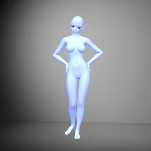

    Back to the original Gooch shader ... I had hidden the diffuse color parameter in my shader since the standard gooch shader doesn't use it. But then I noticed something odd in a render; so I unhid it. And it appears that somehow it is still affecting the overall effect. I'm not sure how since in this sample image, I have Ambient, and Specular strengths set to zero and the shader doesn't refer to the diffuse color setting anywhere.
    It works out ok since I can have more variations of surfaces, but I am curious as to where the diffuse color is entering into the math.
    1024 x 1024 - 33K
