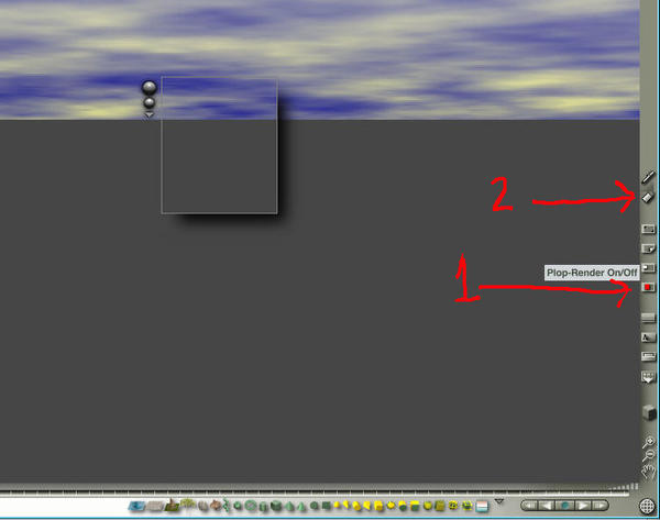

  • franontheedgefranontheedge Posts: 342
    Yes, as Horo says.
    If you can't draw a rectangle and render just that, make sure that Plop render is actually on.
    (see image - point 1) the little red dot needs to be there, if there's just a tiny empty square with no red dot, then click it to turn that on.
    One other point, if you click on the little spray can (point 2 on the image) you can render the exact place on the wireframe that you are interested in without having to start a render first.
    749 x 591 - 44K
