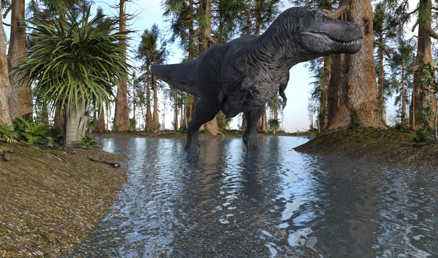

    Sorry, first off, create your scene with the hellcreek models. Then at the top of DS, go to CREATE - NEW PRIMITIVE - PLANE. You want to have 100 or more divisions if your water material has a normal map with it for a rough surface,
    Once this plane is created, then scale it to how big you need it and then set the height where you want the water level to be. Then apply any water shader to the plane and test, adjust as needed.
    If your hell creek models are apart and have space between them, then you might want to create another plane with a darker color as a base for under them in case you can see thru the water shader you selected.
    Here is a quick example. This scene took about 5 minutes to set up and 5 minutes to render. The water shader is from the Stonemason Fern lake scene. I just loaded up that scene and selected the water surface and saved the water as a material preset. I am also attaching what the scene looks like before rendering so you can see the water plane. hope that helps.
