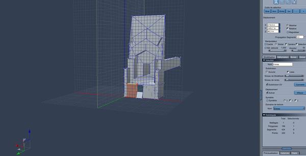

I have a big problem using model room
For some models, the axis manipulator is not in the center of the selection
for example if only one egde is selected, the axis manipulator is far away of the edge
That is trouble me for modeling
Is an other sample in the following picture with one polygon selected
Thanks for your help
http://s5.postimg.org/4q54g4kqf/Bug_Modeliseur.jpg

    It's an Open GL thing, or something. No biggie. You're not seeing the manipulator at all in your screen shot. What you need to do at this point, is switch to a different manipulator and back again. This happens to me only for the translation tool. So I go to scale (S) and back to translate (T). The othe times it won't show up as a centered manipulator is if you have a special tool selected that is awaiting input from you. Just switch back to either Rotate (R), Scale, or Translate to get it back. And then there's always the handy Universal Manipulator.

    I have finaly found the problem
    The problem is when the model is too big and you want yo modelize details
    (in the sample the entrance of pyramid of few meters versus the pyramid of more than 200 meters)
    The solution is to separate the two parts of the model
    I use Ctrl-D to duplicate the model, in the first I delete the entrance and in the second I delete the rest of pyramid
    But the entrance was always not center in the axis manipulator
    Then I selected all (Ctrl-A), move all to the center, and the problem is solved
    When I select one edge (point), the manipulator is on the point and not far away
    The problem seem that Carrara can't manage big model with very far away of the center
    I don't know why
