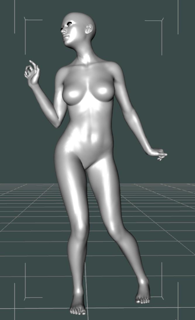

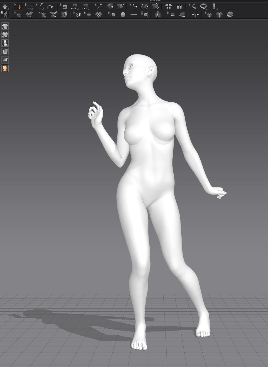

    Just a quick test - G8F to MD8. First imported the A-Pose as an avatar, then imported the pose as a morph (both in OBJ format).
    667 x 1097 - 62K
    922 x 1260 - 95K

  • Interesting. I didn't really understand, or try, anything to do with importing as .obj or as morph target. I will give that some time. I have to say ... this should be a LOT easier. I get the impression that MD projects are in T or A poses?
