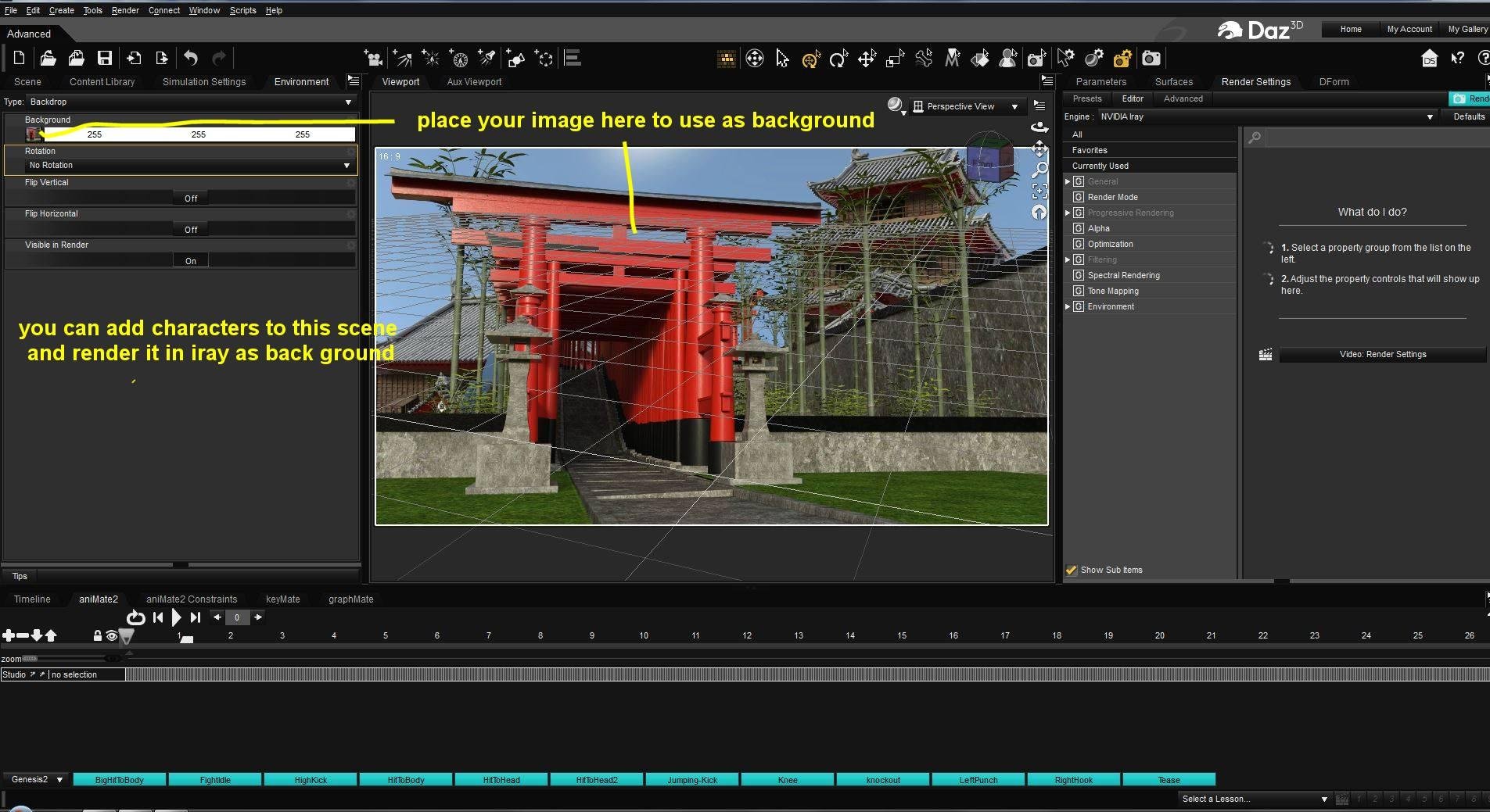

    Step 1 . create a back ground you want to use in your animation . I would render it at 1920x1080
    Step 2 take the render you just made and place it in the environments tab to place it as a background image..    To find environments tab go to the top of daz scroll over to window and then click pane(tabs) scroll down to and click  environment.  there you can place images as background to your daz view port , next add characters props ect.. , next go to render settings and use the daz iray native light  and you can either turn on or off dome it does not matter once you place the environment image, you control light shadow location by using dome rotation setting to match shadows in the pre render back ground
    How you save a camera pov as a preset so you can use it with your pre rendered back ground image , when you make your back ground you want to save your camera angle so it will match your background when you reuse it.  so save it as a preset .  go to file - save as , then scroll down to save as camera preset,  then choose file name location. and you can set your cameras aas animated or  stills, you can save  all camera or just the one hit save ,. bingo done & ready to use with your background.
     see capture and see the render i did using this trick by adding a character to the image as a back ground
     I pretty much custom hand keyframe most everything as need and save some of them for reuse as aniblocks or animated presets now days. But thanks for the offer:)
    put the character in after you put in the back ground and it should come out like this did 1920 x1080 298kb  took 12 minutes to put together & 13 seconds to render
