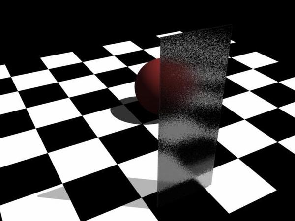

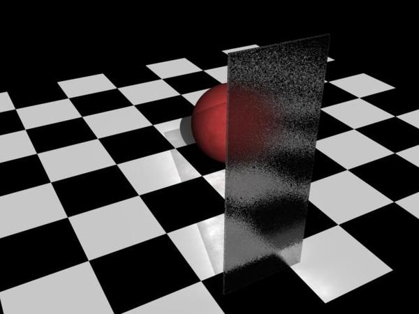

  • TurnerTurner Posts: 116
    edited December 2013
    Here's where I'm at.
    I am trying to figure out how to both reduce the scale of the bump map as well as increase its amplitude. Not sure if that will work, but that's what I'm working towards...
    I'd also like to find out how to adjust so that the material is not "creating light"...
    640 x 480 - 65K

  • DUDUDUDU Posts: 1,945
    It is successful very well!
    For a “sandblasted” glass, there is only one side which is sanded and the thickness of the pane is very thin!
    Caustics don't create light, it simulates the effect light has going through objects with refraction, such as water and glass. It can magnify the effect. Like Indirect Light and the Skylight, you'll have better results if you turn off the scene's ambient light as that is also factored. Also, if the light effect is still to bright, turn down the Caustic's brightness.

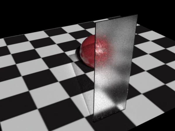

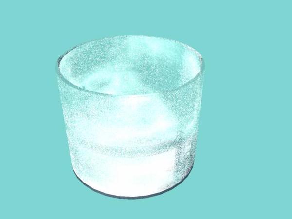

    The trick for not creating light is to make sure your Color, Reflection, Transparancy, and Translucency add up to something LESS than 100%, or at least start there before adjusting things. In particular, Transparency and Translucency should not exceed 100% combined, and Color and Transparency should not exceed 100% combined. You can get away with more in the Reflection channel, especially if you enable fresnel effects.
    Here's a sample:
    Color: black
    Bump: Cellular scale 3% amplitude 200%
    Reflection: 17%
    Transparency: 72%
    Refraction: Crown glass
    Translucency: 20%
    The difference between #1 and #2 is the bump amplitude.
    #3 has caustics turned on. (and I moved the light)
    Edit: Also I turned Antialiasing to Best, which should improve the blurring effect of the bump channel.
    Also, I think Cellular makes a better bump than noise does for this purpose. The math works better when the renderer needs to determine the slope in a particular spot.
    640 x 480 - 30K
    640 x 480 - 33K
    640 x 480 - 31K
    Post edited by briandaz_3e696c2bd8 on

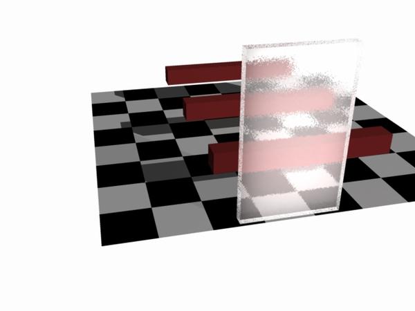

  • edited December 2013
    Also, for creating a more even surface, it may help if you render an extra large image and then resize it down to what you need. The resize will average out some of the random dots to even out the look.
    Also this is the sort of scene where Lux or some other "unbiased" render engine would shine. It even has a "rough glass" shader that does exactly the sort of surface texture you're looking for without using the bump channel at all.
    There is a Lux plugin for Carrara described in other threads.
    Lux sample:
    800 x 600 - 37K
