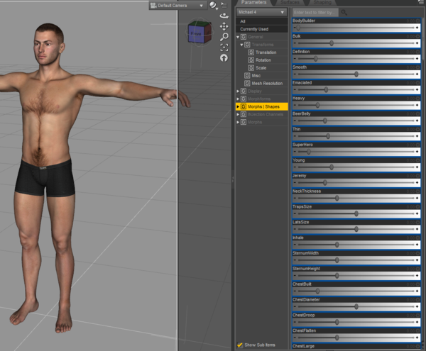

    A picture is often better than words...
    Here is my M4 loaded into DS4.6.1.39 and as you see on the RIGHT all his morphs injected and ready for me to Shape him with.
    Click Image for full size.
    1099 x 906 - 409K

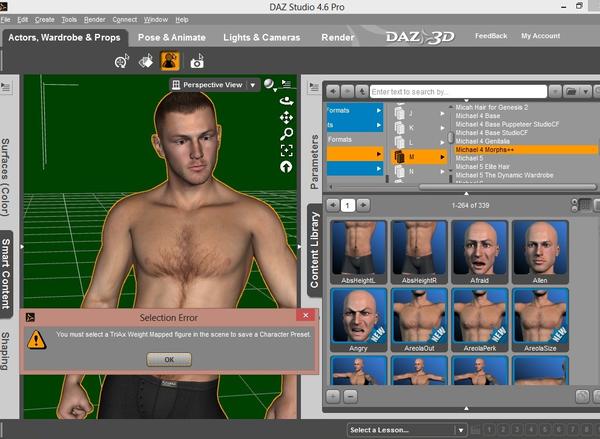

  • lordgabuxlordgabux Posts: 0
    Thanks guys!
    Apparently the download manager did something funny with it. I uninstalled it and downloaded it again and now it's working fine.
    Now, what I need to know if it is possible to save a Michael 4 characters once the morphs had been used on the base figure.
    I tried to do this using the Save as Character preset and it gives an error. Picture is attached, and you will also see how different my dash is from yours. Is there a way to save Michael 4 new characters? I need to come back to the same figures for my projects and it'll be really tedious if I must write down every single thing that I do with the morphs to be able to replicate it afterwards.
    By the way, I haven't seen anything regarding height for Michael 4. Is it possible to change his height at all?
    Looking forward to your comments.
    J.
    991 x 725 - 199K
  • JaderailJaderail Posts: 0
    edited December 2013
    Just save as Scene Subset... Then you can load that figure into anything your working in. And I have customized my interface I prefer the older DS3A look to the default DS4.6 layout. Height is handled with use of scaling, be very careful when scaling limbs as it can cause errors. Check for Length Morphs installed before you use scale.
