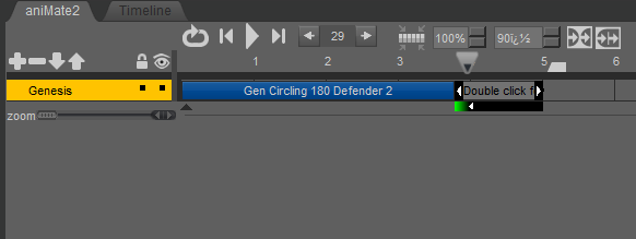

The 90 degrees was an example, I do have a walk AniBlock that does a 90 turn to the right If I set orientation of the next block to that angle it Then blends properly and I do not get foot slide as the second block links to the First walk. Not All Aniblocks need a Orientation fix but Some do, if you get Foot slide or the figure goes off track do Double click on the AniBlock and set the rotation a little at a time until it runs smooth. Many of the Fighting AniBlocks need the rotations to blend properly. And I have noticed some of my Hand made ones did too.
This is Posermocaps SwordPlay, to get a smooth transition from the first block to the second the Rotation was needed. I now use this on any AniBlock that changes the figure rotation suddenly from block to block. I'm not sure Why there is JUNK in the rotation Dialog but the 90 is the important part.
