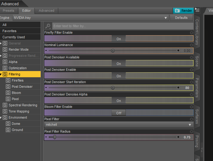

    @Dangerguy01 "traced it to the Noise Degrain Radius under Filtering. Set that (and Noise Degrain Blur Difference) to 0"
    Where are you finding these settings? Both the 4.11.0.383 and the 4.12.0.47 build show the following for filtering on my installation.
