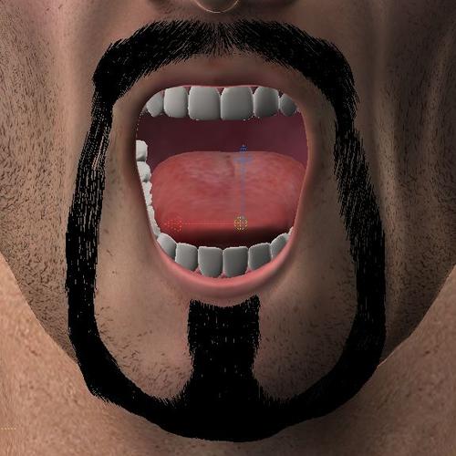

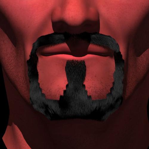

This (below) is my first venture into the hair room. It's a fair beginning. I do like the hair room tools, the few of them I can use.
Following cripeman's advice, I made a chin cap in Poser. It's a figure, so it will animate. But there's something I'm not happy with. See those stair steps? They show the corners of the polygons.
Here's what I'm thinking. I should be able to take that chin cap into the vertex modeler (after I learn to use the vertex modeler), and turn those square polygons into triangles, with the fourth vertex in the middle of the hypotenuse. I think I can turn those stair steps into smooth edges.
Am I on the right track?
Anything particular I should watch out for?
Thanks.

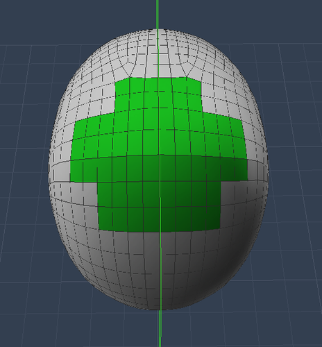

    The best thing to do is going in the modeling room, select the zone and clic to the tab "Model" and "Triangulate Polygons"... (One, two, three times...)
    Post edited by DUDU on

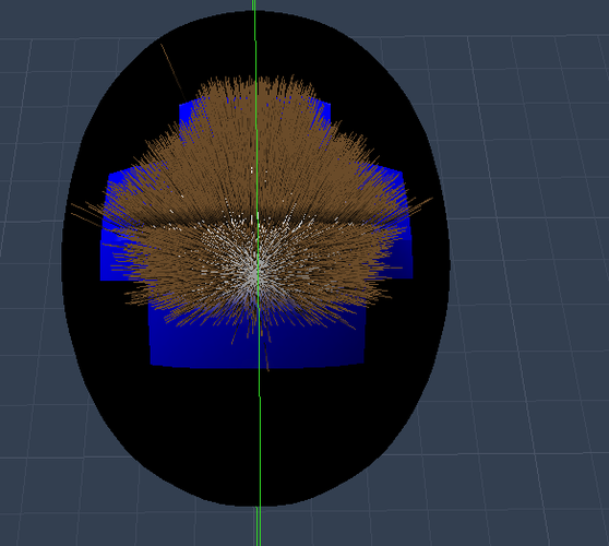

    Or you could use the density add or density remove tool to paint the edges of the polygons to soften them.

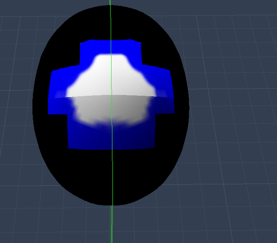

    This is using the hair cap, and it's a bit exaggerated, but I used the Density Remove tool- the clump of hair with a "-" sign to paint around the edges of the vertices. If you make a mistake, you could use the Density Add tool to fix it. It's the hair clump with the "+" sign.
    Now here's another trick to define where the hair grows. You can add a density map in the hair length channel in the hair shader. It's basically a gray scale image map. White is full length, black is no hair and shades of gray in between are various lengths. the brighter, the longer, the darker the shorter.
    I don't animate with the hair, so I usually just grow it on the figure and use the figure' UV map as a guide for when I paint my density map.
    584 x 523 - 68K
    658 x 576 - 59K
    207 x 77 - 13K
    707 x 549 - 166K
    545 x 587 - 110K
    Painting the grow region is a bit easier than editing the mesh. ;-)

    So far, I find the Density Remove Tool to be a guessing game. I can't see my results in the hair room, I have to go back to the assembly room (it doesn't show in the preview pane, maybe because I made the cap invisible). I haven't learned to love that wild gyroscope cursor yet either. The point of it is not clear to me. I'll need some practice at this.
    Rottenham said:
    In the Objects Browser, under hair, there are hair samples on hair caps. You could just delete the existing hair and use those. There are also hair caps that came with Carrara's native content.
    White is full density, blue is no density. You can adjust the tool size by manually typing a value lower than 1 by typing a decimal value. Try starting at .5 and go down from there for more control.

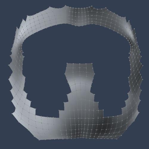

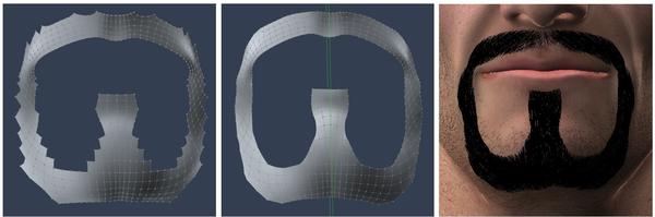

    The problem I have in the vertex editor is that I don't know how to control the movement of the vertex. I need a checkbox that says "Constrain the vertex to move only on the plain of its polygon." These vertices are moving in Z on me. I see tutorials about creating cylinders and cubes, but so far I haven't seen how to move a single vertex.
    As a paintbrush, the Density Remove Tool has a considerable "feather" characteristic. Editing the polygons would be much more accurate.
    816 x 816 - 54K
    I'm pretty sure you can get a sharper edge by adjusting the fall-off in the tool.
    This isn't meant as a dig, but to use any tool to its full advantage, requires practice. It can be frustrating, but I'm sure even Leonardo broke a few marble arms off his statuary when he was learning to carve marble. ;-)

    Having dreamed about this program most of the night, I got up early and was able to edit the chin cap vertices properly. Well, a lot better, anyway. I'm still fussing with it.

    Select one of the points which creates a step - the corner of the step.
    For more control of the movement direction - to follow the direction of the actual polygon, look over to the right panel, towards the top where you may place a selection in "World", "Something Else(can't remember)", and "Selection". Choose 'Selection' and the translation arrows will now align to the direction of the selection.
    Now just move the points along, one at a time, to change the outline shape to something smooth.
    This is why I suggest to model in the assembly room - so you can position the vertices correctly.
    Basically you'll be turning square-shaped polygons into something that more closely resembles a triangle, even though they still have four points.

    Another option to try is to select two points, each being the outer corner of a step, and go Model > Link (Shift Ctrl L) and see if it draws in that missing line. This might actually make for better topology, which would (should) result in better hair placement. If the link is successful, you'll now have a triangle polygon where a step used to be. Continue this process for all offending steps.
    EDIT:
    After looking at your image, I feel that this would make for a better option - but which ever is most comfortable for you. Personally, it would bug me to leave the mesh stepping like that - even though it's not visible. All of the threshold advice and masks, etc., is excellent advice - and should also be learned - as it helps immensely in Hair making endeavors. But singe you've already made this fine mesh cap, you have already created a nice mesh defining where the hair should grow. All you need to do is to eliminate those steps, which is really quite easy, using either of the methods I've mentioned. Might take a little time, but still easy.

    For something like this, I wouldn't suggest using soft selection or anything like that. Looking at your image shows exactly what I mean. You see where there are 'steps' in the shape. Use the translate tool and select one point at a time. You could try using 'X' symmetry, but I would likely do each individually. So:
    I am doing just this as you speak, and I am pleased with the results. Symmetry is working well. I haven't put the hair to it yet, but I am optimistic. If the results look wrong or weird, I'll try the three-vertex thing you suggested.
    This character is a fastidious bugger, and I want him to be well groomed in a closeup. Other characters - I have four in mind - will have different needs, so will use different approaches. Vertex modeling in Carrara has been high on my list of tools to learn, so I'm glad to get started.
    Thank you.

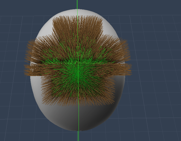

    Vertex editing came out not bad, room for improvement, but OK for a first try. Now here's another hair question.
    The hair brush is able to brush the hair right through the object it's on, and out the other side. Is there some way to stop this, or is hair brushing just a learned skill requiring finesse?
    I think you can restrict it to the mesh, or you can select the guide hairs in the region that is supposed to be brushed and then they will be the only ones effected by the hair tools. You can use the selection tool and drag to select the guides and if you get any you don't want, shift-click to deselect the ones you don't want. You can also shift-select any unselected guides that you wanted to include in the selected guides.
