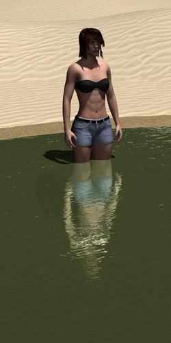

Hi,

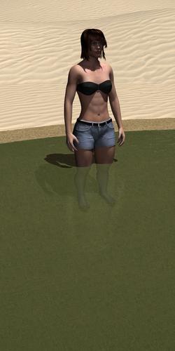

I created an environment with a small waterpond. As well known, water creates refraction for the light transiting between the water and the air above. And the view of each object above the water surface is reflected to the camera.
In DAZ it is possible to use both effects.
But:
As soon as I set up refraction, the reflection is lost (almost).
Is this a problem of DAZ / rendering engeene or are there other aspects?
I append two pictures showing the pure reflection (OK, 100% is a bit too strong but ...) and the effect when I additionally switch on the natural refraction.
Andy
1000 x 2000 - 248K
1000 x 2000 - 236K

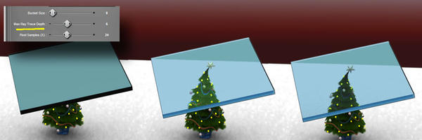

    I could be wrong, but check if your Max Ray Trace Depth is set higher than 1.
    In my render, MAX Ray Trace Depth from left to right: 1, 2, 6

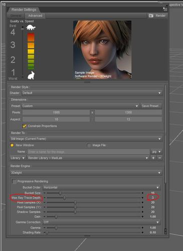

    Here is an example of render settings. You adjust you raytrace setting in there

    changing the "ray trace depth" doesn't influence the effect Default setting is 2. I also observed, that activating refraction overwrites the opacity setting. This somehow looks like nonsense as it is that dramatically changing the reflection effect. But perhaps the author of DAZ had a contrary intention. - Or it is a huge BUG. :-S

    so far this measure brought a little positive effect. Thanks for the hint.
    But in general the current reflection handling (with active refraction) is way too weak.

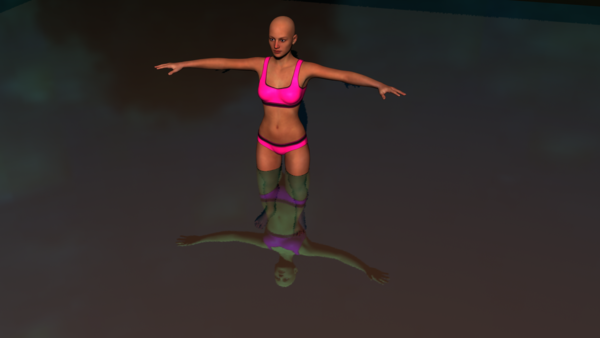

    As Richard said, you should apply Ubersurface on the water instead of using the Default DS Shader which has weak reflections when refraction is active. Ubersurface seems to do it better. You should find it in My Library\Shader Presets\omnifreaker\UberSurface as it comes free with DS. You may have to download "Default Lights and Shaders for DAZ Studio" if you don't find it (Look in your Product Library at Daz Studio Pro)
    My test with ubersurface below

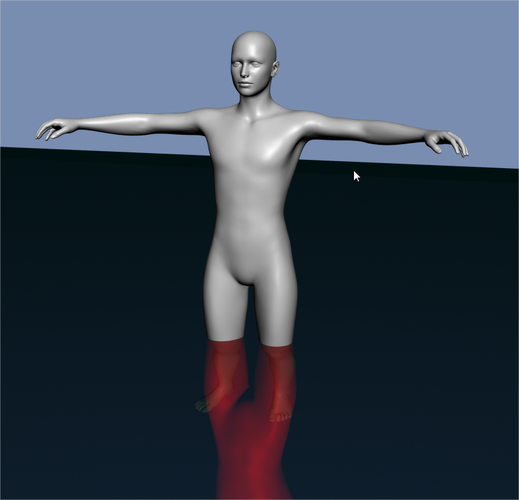

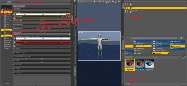

    To apply a shader you have to select the object in the scene tab, then select the surface you want to apply the shader
    Then double click on the "ubersurface base". That will apply the base ubersurface shader
    Once you got the shader applied you just have a few parameters that are important for reflection and refraction :
    1 - In opacity, put the opacity under 100% (I think around 50% should be good but it's up to you)
    2 - Activate the Refraction
    3 - Activate reflection
    4 - Change reflection to Raytrace
    5 - eventually change the reflection color (I've changed mine to red so that you can see what it makes)
    You can tweak as you like after that. The other parameters like diffuse, ambiant, specular will have an impact on the rendered effect

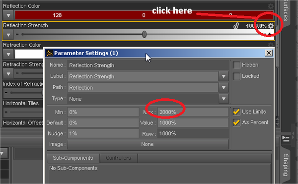

    The optical effects are almost correctly realized within the standard DS shader - only a little too weak. In nature for steep angles you have a clearly visible reflection. If you decrease the angle of view to very low angles the reflection intensity increases dramatically up to 100%. And this is correctly reproduced by the standard DS shader too. The author of that feature only forgot that it goes with the lg-function for the human eye.
    But the ÜberSurface shader ever has the same reflection intensity independant of the angle of view. So for liquids like water this is not correct. For other objects / surfaces this is very suitable.
    OK, so one has to choose the best way for the specific situation. And adopt some of the parameters for the respective render.
    Andy
  • Takeo.KenseiTakeo.Kensei Posts: 1,303
    OK, didn't know that. Learned something usefull.
    So if you think the DS Default shader is better for what you want to do you can simply override the default 200% strength limit and put it at whatever you feel like
    Apply your default DS shader and go to reflection strength and click on the little wheel right of the parameter, then on "surface parameter" and put the max at 2000% for example, then tweak your strength until satisfied
