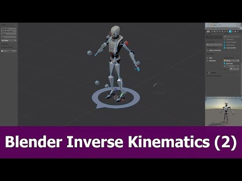

  • OK i found one tutorial that goes over the basics of how to add an IK chain i think.  It had me adding something to the heel and the pole target in front of the knee.  But they were starting from scratch and i'm trying to modify the Daz model. I must not be accounting for some of the other bone properties because when i try to move the heel IK up the leg stays stiff and the entire hip moves up.
  • PadonePadone Posts: 4,347
    You can add the control bones you need for ik to the daz armature. The tutorial below is quite fast and good.
