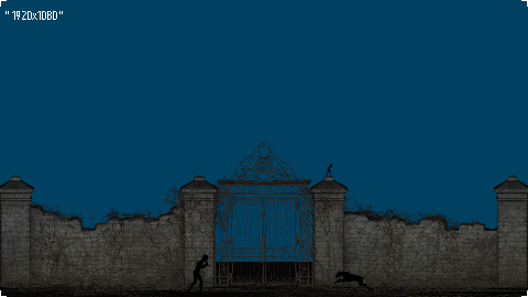

    In a single word, consistency.  If I were to render a background with a local resolution of 1920x1080, I couldn't simply change the resolution to 320x320 without also zooming the camera in or out.  Pretend this underdeveloped, haphazardly thrown together scene is 1920x1080 (and also that it looks good).  A simple change in resolution without adjusting Focal Distance makes the stand-in for the player look like a tiny pixelated blob.
    Were it really 320x320, he wouldn't look THAT bad, but he'd still be tiny compared to the scene.  I stuck the tiny version of him into the original scene (top-right of the gate) just for fun.  I was also going to do something similar for the dog, showing that if I didn't use as stupidly precise of a number for Focal Distance, he could easily end up being a different size than how he should be in the scene...but that might be overkill.
    I could render everything at the same resolution at all times (edit: without adjusting the scale of anything), but I don't like the idea of creating a sprite sheet out of 140 1920x1080 image files that are largely empty .  The other option would be, render everything at 1920x1920, but scale the models then downscale the images accordinly post-render, but I think that would add a considerable amount of time to the process, as well as introducing an additional 'black box' later on in the pipeline.  Finally - call me crazy, but I found during testing awhile ago that rendering at the target resolution gave me more 'accurate' results, than when I rendered at higher resolution s and downscaled.

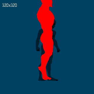

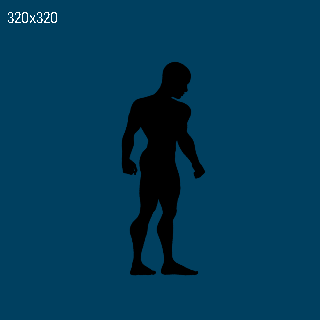

    Okay, so the only way I think I can convey this is via narrative.  I call it, "The story of why I need to calculate Focal Distance"
    Let's say this image is from my player folder, using a DUF file I set up specifically for the desired character dimensions - giving him just enough extra space that he could swing a weapon around, without said weapon going out of bounds.  The camera also has the right amount of focal distance to minimize any alpha noise around the edges (I'm not actually using these settings here,  but look at my cubes in the original post).
    You don't see it, but there are invisible Distant Lights shining directly at him from all 6 directions. Because this setup took such a long time to make and fine-tune, I'd rather just load a new figure in place of the Cartoonized Darius 8 silhouette I'm using as a placeholder for this example.  So let's load one of the big boys, the Behemoth.
    I left Darius there just to show that they occupy the same scene, and the same window.  Unfortunately, the Behemoth is just a little too tall for this one. kenshaw011267, you keep telling me I should just adjust the resolution and render at a higher one, so I'll do just that:

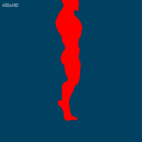

    Drat, I guess that didn't solve the problem! But okay, all facetiousness aside, I'll just slide the camera up a little to fit him in the box.
    Normally, I'd give him a little extra space for arm-waving and whatnot, but just for this example, I'll put him and Darius into the same scene.

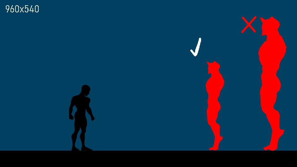

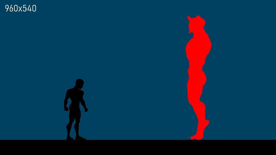

    But wait...he didn't appear that tall compared to Darius when I first loaded him in!  This is how he *SHOULD* look:
    This is absolutely why zooming (changing Focal Distance) is necessary.  So, I can zoom out the camera, whose local dimensions are still 480x480, until I have a version that seems about the right size...
    You'll see he has a lot more space to move his arms now.
    But he's still a little tall. If only I knew a formula that would give me the exact value I needed for Focal Distance, in order to keep these two characters their appropriate size. Unless I'm missing something obvious, changing the resolution does not adapt the viewport the way 'Change Canvas Size' would in a paint program.
    I'm going to look into this spot rendering, but I'm not sure it's the right solution.  Does it cut down on the render time? Rendering these guys from a ridiculously far away distance is more time consuming than using the window presets I set up, and I'm not well-versed in Photoshop for making an automated process (though it's something I should really look into).  I have a bunch of other trepidations as well, but I think this post is long enough.  I spent the day doing this, but I think I may have an idea for how to work out the math that I can try tomorrow.

    By changing the large figures resolution you effectively increased his size, he is now 480 pixels tall compared to the 320 of the original figure. Looking at it from someone who doesn't know anything about sprites and games, I would set the small figure so his feet are touching the bottom of the 320x320 square and do the same with the large figure in the same size of square. if the large figure is still too tall for the square then enlarge it but also enlarge the small figure square to the same dimensions. This way both sprites will occupy the same area of pixels but the large figure will look taller than the small one.
  • kenshaw011267kenshaw011267 Posts: 3,805
    Changing the dimensions of the render will not change the dimensions of a figure, it is just rendered with more pixels.
    So in the above example either the camera position needs adjustment or the characters base position. There is still no need to be mucking about with camera focal distance.
    For instance:
    320 x 320 - 68K
    1000 x 1000 - 582K
