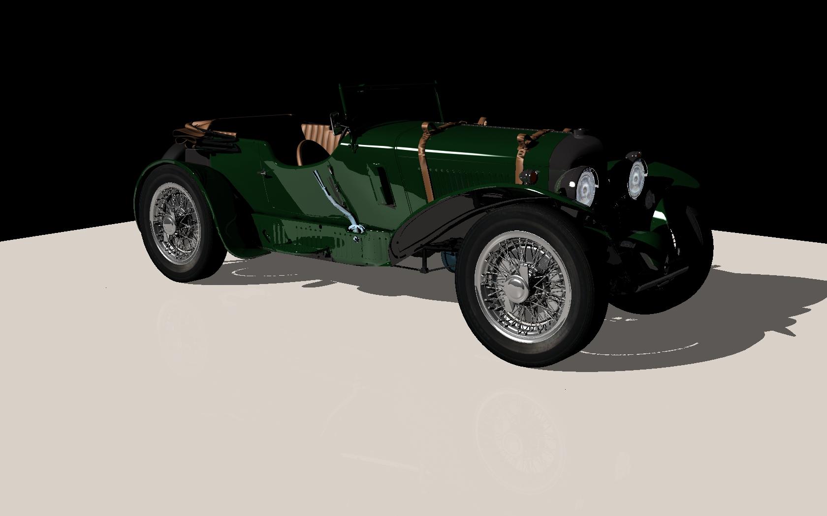

Using an HDRI from hdrihaven and IBLmaster  for my car renders usually gives good shadows, but some imported models seem to only cast partial shadows, as if some parts aren't stopping the light.... Other models have no issues... Any ideas? I;'m sure it  has to be something with the mesh, but I can;t figure out what..
Any input would be greatly appreciated..

    Does converting it to SubD make any difference? Try increasing trace distance? Lowering shadow bias?

    Does it cast proper shadows with a DS distant light onto a plane?
  • Matt_CastleMatt_Castle Posts: 3,298
    I'm fishing a bit in the dark here, but are the problematic surfaces actually opaque from both sides in a render? I'm wondering if it's possible that your import format might have somehow set the material to be one-sided somehow.
    (At the same point, which shader is actually set on those surfaces? Imported models presumably won't use Iray settings, and trying to use a non-Iray material can have some bugs).
    edited July 2019
    I assume that's a 3DL render, and the DS default shader usually does not have problems with backfaces. But yeah, could be worth a try inverting normals for some or all the surfaces to see if it makes a difference. Also in preferences/interface one could try enabling the backface lighting.
    D'oh. Yeah, I read "HDRI" and thus immediately thought "Iray", but then I don't have/use IBLmaster myself (and only use 3DL for some very specific jobs), so I forgot that's exactly what it's supposed to do.
    Still, seeing as it is specifically imported models, I think it is worth checking which way the model's faces are pointing, as I've definitely had the "Oh yeah, all the faces are inside out, that's why it's not working" problem in some renderering programs.

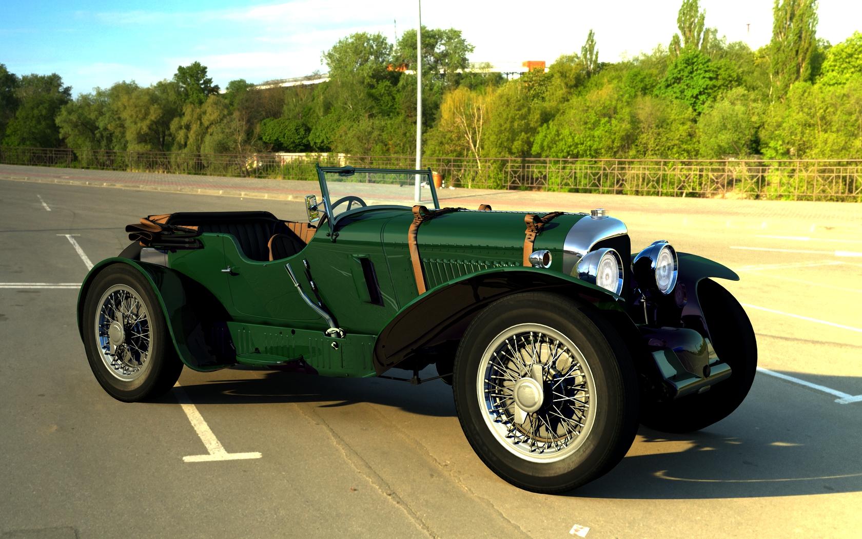

    Hmm.. Normals seem ok, and flipping them didn;t help (just as an experiment ).. BUT.. taking the model in question, and popping it into a scene with a pane and one standard DAZ plane primitive - and Voila! - so is it something in IBLmaster,?? time to experiment more..
    Interestingsurprise Running out of ideas, would love to know, if you find a solution;) I remember IBLM having some issues but there was an update that seemed to work alright. Something related to normals IIRC. What if you slap a plane under it in IBLM and hide the shadowcatcher? Still wonky shadows?

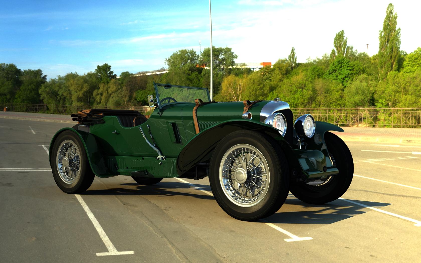

    Fixed --- when in doubt RTFM!!!  Section in the IBLmaster doc about clipped shadows... increased the Maximum Tracing Distance in the IBL Light Settings to 5000...
    1680 x 1050 - 1M
    Post edited by hacsart on
    yes Lookin good:)
