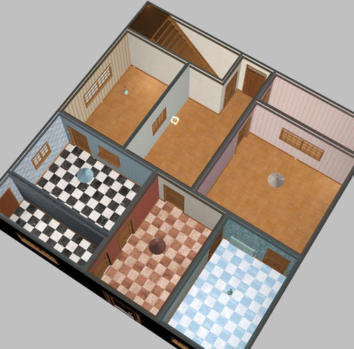

    That brings me to another question. In Home One Apartment, can the rooms be reorganized?
    Can rooms be duplicated? For example, if i want to add another "bathroom" (upper left hand corner room i assume), and place it in the living room where the stairs to the attic (again, i assume) is to make another smaller bedroom; is that doable?
    And there is mentioning of a "Utility Room", where is it?
    -MJ
    Post edited by MJ007 on
  • macleanmaclean Posts: 2,438
    edited December 2013
    -MJ
    Yes, you can add rooms (within reason). Here's a quick render of a 2nd bathroom added to the living room. Actually, in this position, all you need to add is a wall, but you'd probably want a different setup from the one I used. (After I did the render and closed DS, I noticed I'd used a wall with no door. I should have used the opposite wall. Doh!)
    Here's the deal. Most of the pieces from Home One and Room Creator are interchangable (including wall textures). I used the same measurements for both sets. When I added that bathroom in the render, all I did was load it and use the RC toolbar poses to move it into position. (Each 'jump' is a step of 170cm, so even if you don't have RC, it's not difficult to do. Just use multiples of 170). If you have RC and wanted a room shape that isn't in Home One, it's possible to create it, and it'll fit into the apartment.
    The Utility Room is really just an empty area in the kitchen. When the 2nd kitchen wall is switched on, that area behind it, (bottom left of the render) is the utility area.
    mac
    800 x 787 - 151K
    Post edited by maclean on

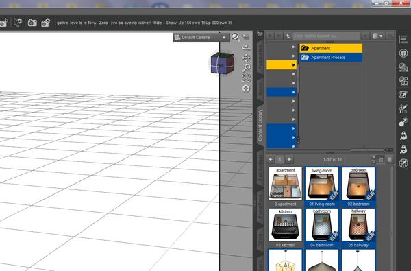

    One problem I have though, is that the toolbar that you can add to make moving things easier has changed to text. Anyone know why, and how can I get it back to icons.
    1091 x 719 - 252K

    wilmap said:
    I love these sets. Very versatile.
    What's happened is that the paths to the icons have changed. I suspect it's because you may have moved the Toolbar folder after installing the toolbar. It should be in this folder
    daz studio/content/Maclean/Room Creator/Room Creator 2/Toolbar
    If you press F3 in Daz Studio to get the Customise dialog, and expand 'Custom' in the left-hand pane, you'll see the toolbar actions. Right-click on one and choose 'Edit custom Action' from the menu. In the new dialog, you'll see the file path to the action. If it doesn't correspond to the file location, you have 2 choices. Either move the folder to the correct place, or edit each action to match the new location, so they find the icons. Do that by pressing the Browse button (with the dots .....) and find the correct file for that action.
    Let me know if this solves it for you.
    mac

    The Toolbar is in the place you have quoted! I have removed the toolbar using your script and then added it again several times before, but for some reason it changes back to text after a few days! No idea why. It's easy enough to remove/add but was just wondering why it was happening. Thanks anyway.
    That's weird. In fact, I'm baffled. The only hting I can think of to try editing one custom action to the right path (which will be correct anyway), and see if it holds. If it does, do all the others.
    mac

    This is weird. Can either of you try something for me?
    Go to the content folder Maclean/Room Creator/Room Creator 2/Toolbar and right-click any one of the poses. Choose 'Create custom action'.
    Now go to F3 customise, select the action (it'll be at the bottom of the list in custom), and right-click it choosing 'change icon'. Browse to the Toolbar folder and select its .png.
    In the right-hand pane of Customise, click on the Tool Bars tab, expand RC QuickPose and drag the new action over onto it. Click OK on the Customise dialog, and the new action should appear on the toolbar with its icon. And hopefully stay there.
    If it doesn't, then it must be some sort of bug in DS. You could also do the same as above with any other DS preset and a random icon to see if it works or not.
    I don't think it's an issue with the Toolbar. It's a completely new version which was rewritten for DS 4. And anyway, losing icons isn't something it ever did, even in the old version.
    mac
  • sfaa69sfaa69 Posts: 353
    I deleted your toolbar, which was still the icons, as it should be, and closed Studio. I then followed your directions until I got to the part about expanding RC QuickPose. The attached is what my screen looks like once I click on the Toolbars Tab. What do I do next?
    Ahhh... unfortunately, you shouldn't have deleted the toolbar. Because when you try to drag an action to it, it won't be there.
    What you could do is just create a new toolbar and drag the action to it. Like this.
    In the Tool Bars pane of Customise, right-click on any name (like Help, for example), and choose 'Add Toolbar'.
    Give it a name, then drag the custom action to it as described above. You can always delete the new toolbar later.
    What I was trying to find out was if adding an action to the RC QuickPose toolbar directly from the content pane works properly and keeps the icon.
    mac
