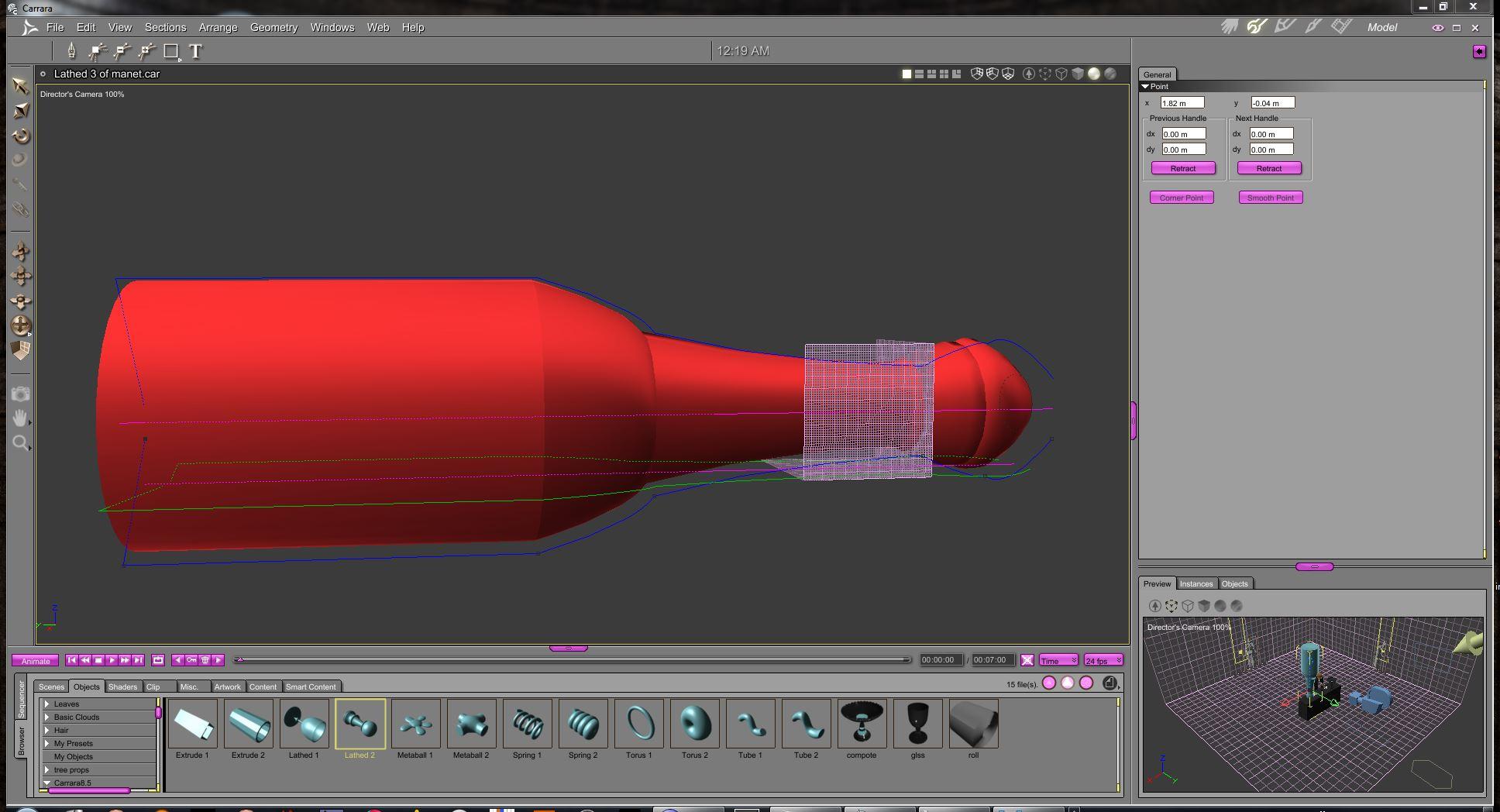

I am moving in on that Spline room like a thirsty hoe
making a champagne bottle with a big punt on the bottom even
Keep at it Wendy! If you want advice, just ask and I will answer if I know how to do it.
I just started with a few of the examples and figured out moving, adding and removing points for the profiles can create all sorts of phallic dildoish things
and bottles and containers!
Early days still don’t know enough to ask questions but figured out the basic concept of lathing a shape by moving points, know if you intersect them you get a multiple point warning dialogue pop up so have to pull the little angled line on it to remove the overlapping lines.
the only thing I am wondering is if the base profile shape it’s extruded along can be anything other than a oblong or an ellipse.
I want to do stars or other non uniform shapes but it does not seem to let me.
You can draw any shape you want to extrude. It can also take Illustrator files to use. To draw a shape, use the pen tool on the drawing plane to draw your shape. You can then use the curve tool on the points in the shape to curve the lines.
You can also curve the shape of the extrusion path.
TY, I did not try from scratch
using the pen tool on existing mesh was messed up
will play with it more
To get the hole, you would combine shapes as compounds. I may start a thread with a basic tutorial tomorrow or this weekend.

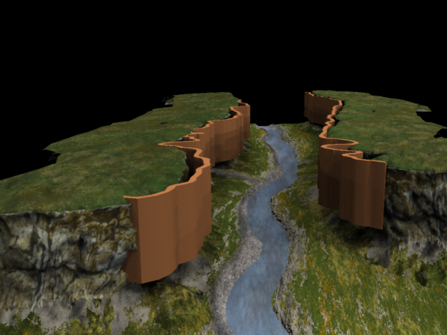

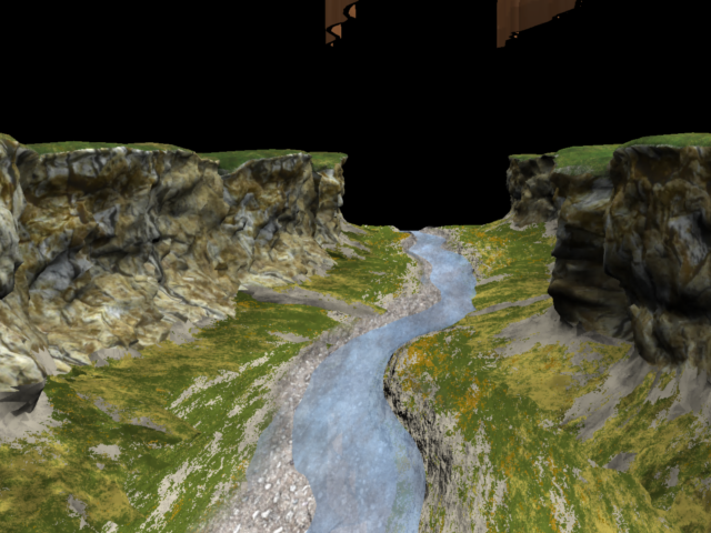

I had forgotten how well that works. I did my cliffs for my terrain by tracing the aerial surveyed contour of the actual location from a site diagram, then imported them into Illustrator to vector them, then into Carrara and extruded them to a certain height to use as a template (see brown template in first photo) for creating the ins and outs of the cliff faces to put into a height map (which I made based on the survey data of cliff height). Once I got the general contours, then it became a vertex object. I then dropped the template back in to create the bumps and lumps with dispilacement and moving vertices around staying within the surveyed conttours.... then textured.
I am still working on the terrain and adding more surrounding terrains and features which have to be guessed at. I did travel to the location to take photos of the hills and such, but after 30,000 years it probably has changed LOL!
Note: I did try to do some of this in Zbrush, but actually? Carrara modelling room did a good job for me. Going from a heightmap terrain to a vertex model without having to change programmes is really useful.
