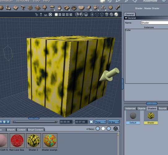

    I might not be fully understanding your question. But, if I wanted to create a duplicate shader and edit the color channel, but still have original, and then save with a changed name, I would use the shader category in the browser tray. Seems to work for me. But based on your reference to .cbr files, maybe you are trying to do something more complicated?
    736 x 678 - 81K
    894 x 686 - 221K

    If I instead drag shader "XYZ" from the browser to my master shaders list and then do a copy-paste, I get a duplicate shader named "XYZ 1" Double click that and make edits, Drag and drop from the master shaders list back to the browser and you will get the save dialog shown in diomedes screenshot. Rename it whatever you like.
    One curious thing I found, was that if you drag a shader from the master shaders list that has not been selected (with the yellow line underneath) that the dialog says "no name" instead of its actual name.

    For those that may not know, If you close the shader window, you can still find it by selecting the shader tray on the right side of the screen. Even if the shader is not in use (and you haven't removed unused shaders) there should be a thumbnail for it. To save it, just drag and drop it onto the shader browser in whatever directory you wish. A dialogue will open where you can name the shader. You can also name the shader in the shader's general tab when you select the thumbnail, as well as see all the objects it's used on.

    The easy way is to just put the shader on something, anything, a shoe for example.
    Then you can simply drag it back down to the shader tray and save it with a new name.
    Or change shader folders and save it in the new one with its original name.
    You can drag it back down as many times as you want.
