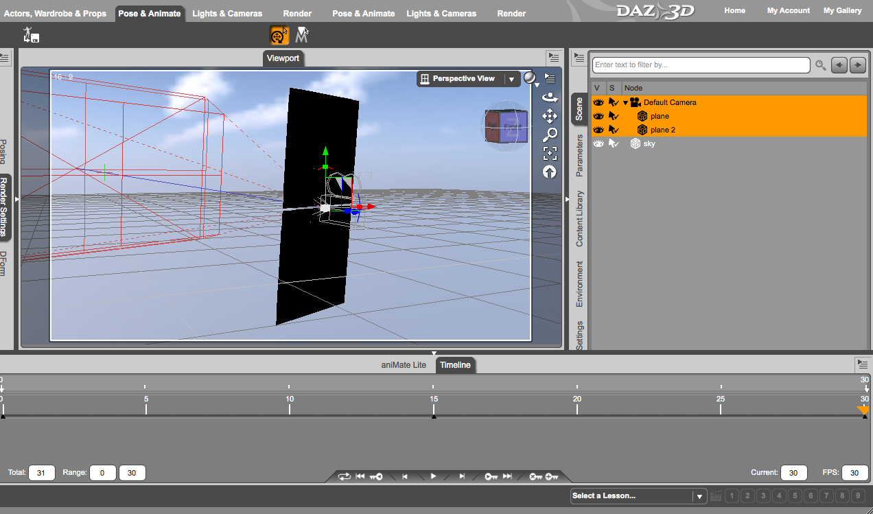

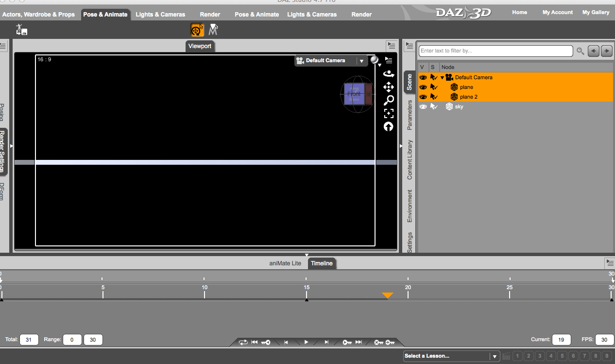

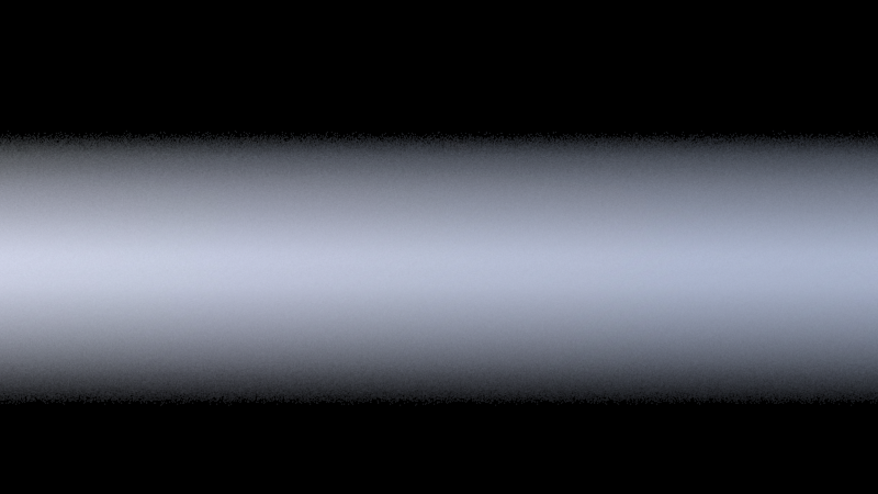

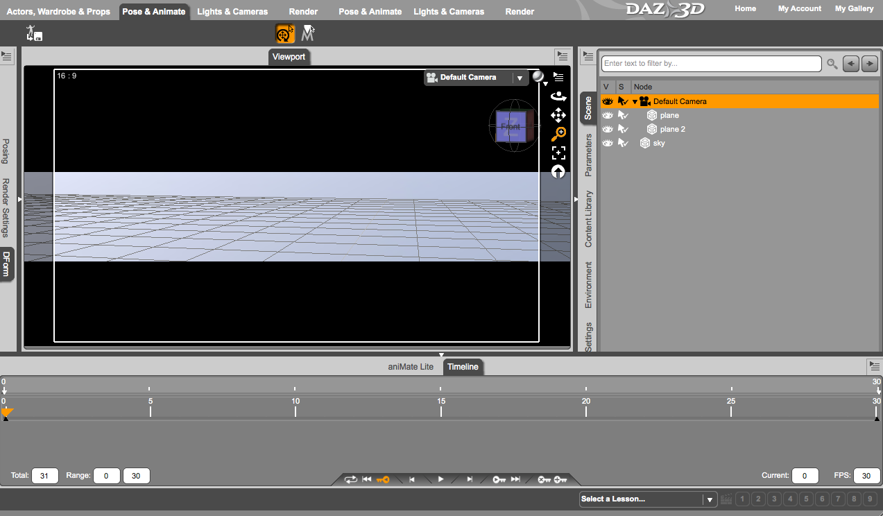

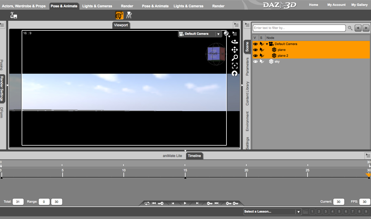

    Don't see the problem.
    Created a camera, created two primitive planes and positioned them in front of the camera to mask the view, parented them to the camera, animated the camera and the planes to simulate an eye blink. Things are working as supposed to, so a bit more info on your setup would be required to find a solution;)
