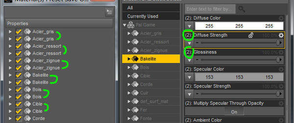

I have a bizarre thing with one of my hard surface models created in Hexagon.
Imported and rigged in DS 4.6 without any problem, when I look to the surfaces tab I see a number in front of each property [ (2): in my case ]. Sometimes (unpredictably) RGB values shows “Multiple”. I presume that there is more than one value linked to each parameter. (See attached image). Obviously, if I try to create a material preset each material appears twice.
I don’t know how it occurs and worst, have no idea where to dig to fix the problem or remove extraneous material.
Any idea ?
Regards,
688 x 289 - 75K
I've seen that happen before in some of my models too. The only fix I have found is to pull it into another UV mapping tool and remove the extra surfaces. I believe it is actually a bug in Hexagon not DS. Try using the free version of UV Mapper and see if it can help.
As far as I've been able to determine, the bug has something to do with communications between Hexagon and D/S. Sometimes D/S is simply copying ALL the materials from Hexagon [whether or not they are on the .obj being created] ... and sometimes D/S creates one all by itself [esp over the bridge] "just because".

To note though; If you have the same shading domain on 2 objects; and both those objects are selected, they will show up as (2) same name.
It is best to have all pieces with their own Shading domains AND each Shading Domain "has to" have its own material assigned to it, IN HEXAGON. Once the items are cleaned up and being worked on in D/S, then you can assign the same materials and colours to the shading domains/materials.

If I’m really stuck, I can consider using UV mapper to re-UV the geometry. But I don’t think my problem to be due to a bad geometry or UV map. I say this because if I import the whole geometry (.obj) into DS; everything is correct. I suspect the problem to come from some questionable manipulations I’ve done while setting the figure up and to be DS sourced. I’m quite sure that, if I re-rig the figure correctly, things will be fixed. I want to avoid doing this twice for at least 2 reasons: 1- it is long and cumbersome, 2- understanding the reason may help improve DS and my own understanding.
I use a similar method to the one described by Patience55’s (export parts, clear and reimport them) to recover from some sucked situations: fancy bounding boxes, bad origins. Mainly geometry issues; didn’t have lot of problems with materials, except a “default material” appearing without any reason.
