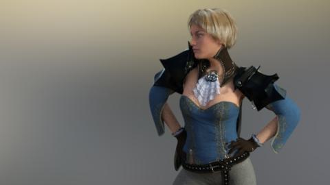

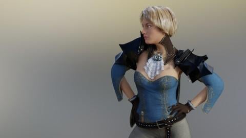

    As an example here she is the g3f first rendered in iray then in cycles. I used studio 4.11 and blender 2.80. The plugin also imports cameras, lights and the hdri environment. That's why I can make the two pictures with the same lights and camera angle. Before exporting I converted the g3f materials to the iray uber shader because this is what is best converted for cycles. This is also what works best for iray so it's a win win anyway.
    That apart I really just exported and rendered that's all. No materials tweaking was needed in this case.

  • GreymomGreymom Posts: 1,147
    Thank you for this info and demo, Padone!   That settles it - I will have to learn Blender 2.8!

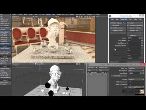

    I do Like the fast VPR (Veiwport renderer) I have in my seat of Lightwave 2015.
    My next major film project will likely be rendered in LW ,instead of My old C4D ,since My obj /MDD workflow for Genesis is completely transferrable to Lighwave as it has a robust MDD importer as well as Alembic along with FBX of course.
