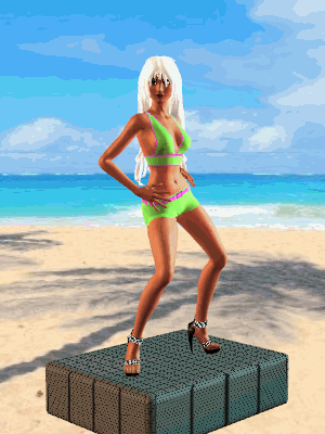

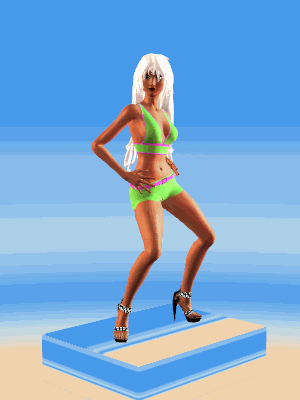

same animation
i repeated it 5 times using bLooper
i added a sinewave motion to the YTrans of the hip node using the upcoming script
i used mcjAutoLimb and mcjKeepOriend to "re-attach" the feet to the ground
oops actually i replaced the vertical movement instead of adding it tp the original bouncy movement
here the little shocks in the animation may be due to "aliasing"
because of the low frame rate of 10 fps

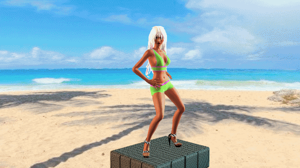

the vertical motion was created using the "expert" mode and a function like
there !
i removed the hard-knock movements from the hip rotations using mcjShiftAnim's simple 3-samples box filter
oops ... error
working on it
well unfortunately i had to use good old mcjCycleFilter to filter/smoothen the animation curves
but i'll fix the issue that caused the problem
looks quite good though now

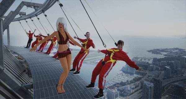

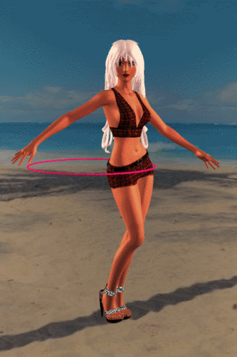

hula up
added load/save function
so if you created a formula like
you can save it as fx_FlooredSine.txt
and re-use it at a later date
( this formula was used to add some movement to the chest node's Bend channel
and the side-side channel used
since this is an additive effect ( val = val + ... ), i did not wipe out the important
chest stabilizing work performed by mcjKeepOrient prior to this

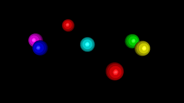

the looping-time shift is very important for cycling animations, since it helps you tweak anticipation and follow-through

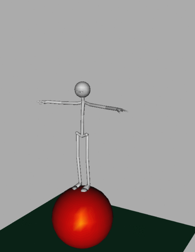

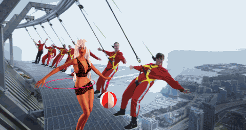

in figure 2 i used mcjShiftAnim to animate the balls using the "Set" processing and the "Parameter"
( actually i used parameters locking and mcjParent to copy the first ball's Z motion )
then i used mcjShiftAnim 's Looping-Time-Shift to delay the animation of the balls by, respectively, 5, 10, 15, 20, 25 frames
