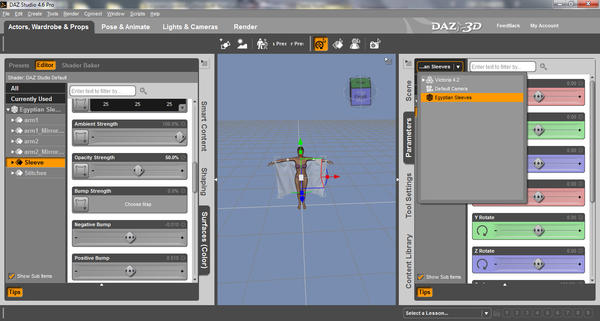

    The helpers go around the arms I believe and that is what "pulls" the fabric as your character moves through the animated drape. Can you post a screen shot of the dynamic tab so I can see if perhaps the settings are odd in it when you run your draping.
  • edited December 1969
    Unless something's changed I don't know about, that box next to the item's name means it's a prop. No rigging, dynamics, helpers, nothing to it other than basic mesh geometry as if it were a mere .OBJ file.

    The Helpers are the WHITE Cuffs, they need the Dynamic engine to DRAPE, they need set to Collide with the Figure. You turn them OFF in Surfaces Tab with the OPACITY slider. Then the sleeves Drape just as the Dress does when a Dynamic Animation is run.
  • DraagonStormDraagonStorm Posts: 748
    The sleeves may look like they are just a prop, but they are not. The sleeves were created using Optitex's software. DS Dynamics can only be used with items that were created with Optitex's software.
    The sleeves (like the Kimono) are not rigged because they are outside of V4 rigging constraints. That is why you can not use 'fit to'. You have to start V4 in the tPose. and use the timeline to pose her at a later frame. And drape the sleeves using the Animated option in the Dynamics Clothing tab.
