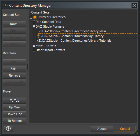

  • Syrus_DanteSyrus_Dante Posts: 983
    edited July 2019
    You can go to the Content Directory Manager (press F2, select Content tab, press the button at he bottom) and move your main library to the top quiet easily with the Move buttons in the left bottom of the dialog.
    Otherwise I would also make shure that there are no dublicated content files in those libraries. I've had those situations where I installed free stuff by accident to the main library and not into my free stuff library so I manualy installed it a second time into the right library and used a duplicate file finder programm to compare the files in both library folder sets and delete the duplicated from the main library. I tried a few free tools but the best software I've found for this taks was:
    Easy Duplicate Finder (like the name implies its easy to use and does a quick folder compare)
    http://www.easyduplicatefinder.com
    Reasonable NoClone (more advanced and not that easy to use but it can also compare files byte by byte to find identical or almost identical files of different file names)
    http://noclone.net
