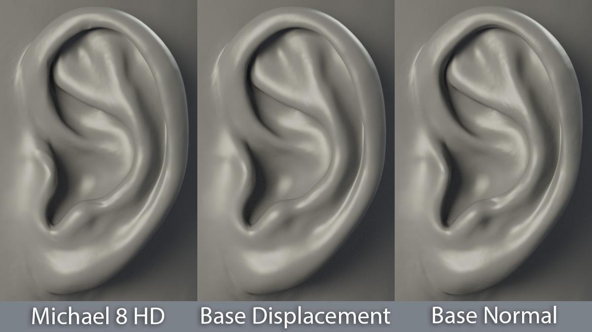

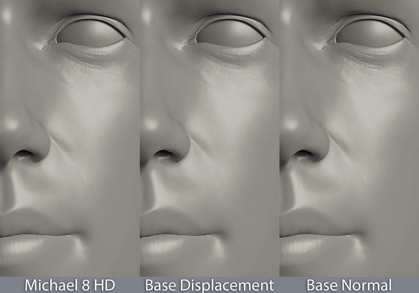

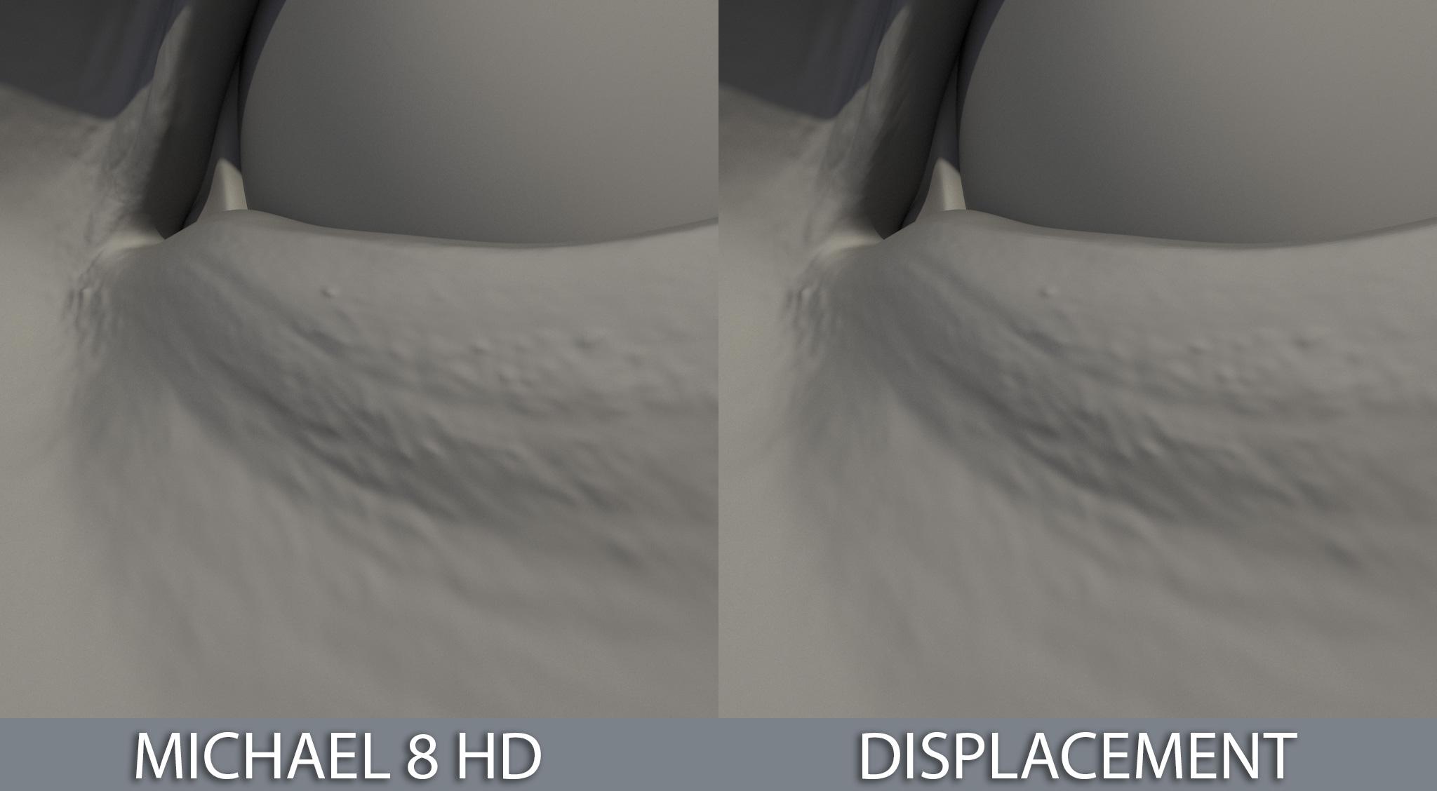

    This is the only picture I currently have access to (I'm away from home at the moment), and it was a test where I hadn't entirely nailed down the parameters yet (or even had the correct recipe for the character on hand), but this was a G8F conversion of a gorgon character I based on Lekkulion for G3F, originally an HD figure.
    The finalised version of the conversion is very hard to tell apart from the original, at least without relying on differences in the base figures themselves, such as their expression details or bending.
    The main issue with converting to a displacement rather than an HD morph is that the displacements only apply at the rendering stage, so they can't be taken into account in collisions, which does make them more liable to have issues with mesh clipping.
    However, displacement maps are also compatible with the bump map parameter, so it is possible to partially apply the results as bump maps rather than entirely as displacements, so reducing the positive displacement slightly and dialling some of it in on the bump map channel reaches a compromise where you get to keep most of the detail in the silhouette but with much the same look otherwise and no need to slap adjustment modifiers on everything.

    Here are some test renders of extracting HD details from Michael 8. I exported Michael 8 HD out to obj at SubD 4 and used Mudbox to extract the displacement and normal map information. The 'Base Displacement' and 'Base Normal' renders are a base level Michael 8 exported to obj, reimported back to Daz Studio and converted to SubD. This imitates the workflow used when taking Daz figures to other software packages. The 'Michael 8 HD' renders are at SubD Level 4.
    Click on the attachments to see in more detail:
    As you can see, the Base Displacement render is very close to the Michael 8 HD render. It is a little bit softer though, and that's a limitation of working at 4k resolution.
    The Base Normal render looks even closer to the Michael 8 HD render, but you do loose the physical surface changes that come with displacement maps.
    The differences are more apparent around areas such as the ears, which have very minimal detail when exported at base resolution.
    One thing this exercise has shown me though is just how little detail there is in the Michael 8 HD Add-on. But if you don't care about it being 1-to-1 accurate with the HD details, you could use both the normal map and displacement map to increase details too.

  • Matt_CastleMatt_Castle Posts: 3,264
    What bit range have you got on the Displacement maps? The fact that you have got that detail in the 4K normal map implies that the texture resolution is enough to support it, so the fuzziness may be due to the range of the image.
    Displacement is using 32bit float exr files, so range isn't an issue. I get closer results in other render engines using the same displacement map; here is a comparision rendered in Redshift for Maya:
    There are a couple of possibilities, but I haven't done enough testing to establish the exact cause. I'm leaning towards a texture filtering issue, either from Mudbox when generating the maps or Iray when rendering the maps. That would explain the difference between the details in the normal map and displacement map. When it comes to map filtering, the displacement only has greyscale values while the normal map has RGB values. So there is more information in the color channels of each pixel in the normal map which may result in less aggressive filtering / interpolation between each pixel.
    This can be overcome by using 8K displacement maps because there are more pixels in the image, so the effects of map filtering are reduced. But for a GPU renderer that can be computationally expensive.
    Perhaps you can tweak settings within Iray to get better results, but I just don't know enough about it and the implementation within Daz Studio to do so. Or it may be caused by something else I'm overlooking entirely; this is just speculation really. Either way, there will always be some loss of fidelity when you have to take into account different applications, texture filtering methods, color space interpretations, file types, compression and decompression methods, texture extraction methods, subdivision methods, uv subdivision methods, texture resolutions and mesh poly counts. But I assume that for most people a 1-to-1 pixel perfect result isn't required, and the workflow to get 95% of the way there will be more than adequate.

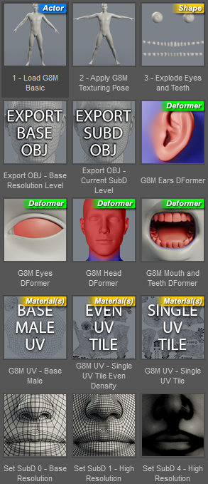

    On a related note, I spent some time over the weekend preparing some assets to do a video tutorial on the workflow discussed above. As part of that, I have created my own Development Kit, which helps to speed up a lot of the tedious or repetitive work involved when working on characters. Here is a screenshot of the contents so far:
    Some details:
    • Load G8M Basic - Loads G8M with a slightly reflective grey shader (used in previous renders), SubD Level 1, SubD Max Level unlocked to 4 and no eyelashes.
    • Apply G8M Texturing Pose - A custom pose to allow for easier texturing. Fingers and toes have been spread apart and straightened, the mouth is partially open to allow easier painting of lips with little distortion, the eyes are partially closed for less distortion on the eyelids while still giving access to the eyeline, and the limbs have been adjusted to increase access to the tight spaces under the arms and between the legs.
    • Explode Eyes and Teeth - A custom morph that moves the eye and teeth geometry out to the left of Genesis 8 Males head. The sclera, pupil and iris have been separated from the cornea and eye moisture. The teeth have been aligned and spread out for easier access during texturing. This morph is also great for baking maps in other software because it reduces overlap between the meshes.
    • Export OBJ - Base Resolution Level - Changes the selected figure to Base Resolution and SubD 0 and prompts for a location to save an OBJ file with the appropriate settings for Mudbox, Maya and others (these are the settings I use for all my OBJ exports).
    • Export OBJ - Current SubD Level - Uses the currently set Resolution and SubD Level for the selected figure and prompts for a location to save an OBJ file with the appropriate settings for Mudbox, Maya and others (these are the settings I use for all my OBJ exports).
    • G8M Ears / Eyes / Head / Mouth and Teeth Deformer - Various preset weight mapped D-Formers. Generally used with 'Attenuate By' when importing morphs with Morph Loader Pro to restrict where morphs are applied.
    • G8M UV - Base Male - Changes the 'UV Set' to the default Basic Male UV layout.
    • G8M UV - Single UV Tile Even Density - Changes the 'UV Set' to a custom UV layout. This moves all the uv shells into a single non-overlapping uv tile with equal texture density while maintaining the original orientation of the uv shells. This is good for projecting full body photographs to ensure the details are captured evenly. However, any textures created with this UV Set will need to be projected back to the Basic Male UV layout if you want to combine it with other Daz textures.
    • G8M UV - Single UV Tile - Changes the 'UV Set' to a custom UV layout. This layout moves all the UV Shells into a single non-overlapping layout while maintaining the original layout of the skin UV Shells. It is optimized for skin painting and texture baking, so the eyes and mouth (usually textured separately) are placed into blank areas of the Torso and Legs uv tile. Textures created with this method just need to be cropped in an image editing application to be used. For example, a single 8192 x 8192 texture with this UV Set can be cropped into 4 individual 4096 x 4096 textures that line up with the original Basic Male UV Layout (excluding the eyes mouth).
    • Set SubD 0 / 1 / 4 - Self explanatory.
    I may still add a few more things, but this will be released either with the video tutorial for the workflow or released before if I can't make time for the video.
