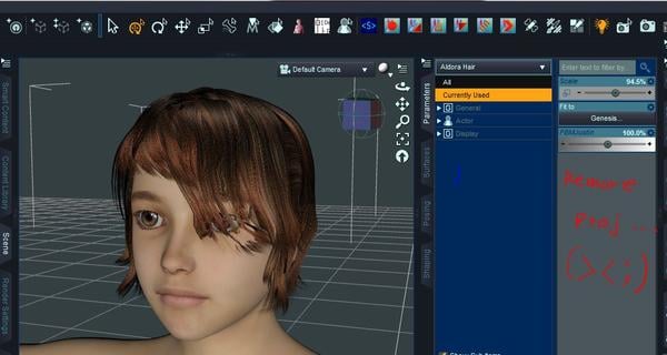

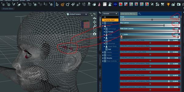

    So,, now I test to make morph template for auto-follow justin,
    it is not so difficult I think, but when I export only apply justin FBM,
    I found,, it is more simple problem. ^^;
    and if someone (DAZ or vendor) hope to remove this problem, it is easy.
    I know, this product have been up-dated several times, but when remove problem,
    they need to take care more. I know many times if up-date to remove someproblem,
    forget something,,and make another problem so easy,,
    the first pic, it when I apply FBM justin. the red eye lash move by three morphs.
    but even though I remove two morphs about eye lash, the eye lash bury in head .
    it means ,DAZ (not vendor sorry!! ) include the eyelush moving in main FBM too.
    not only with ERC eyelash morph.
    it is simple mistake,,, maybe when try to remove other problem (I remember there are missing ERC MCM for poze controller
    about this product)
    without intention, include this effect (lash bury in head) in main FBM.
    I think it should be correct,,,
    1331 x 644 - 241K
    1258 x 629 - 206K
    Post edited by kitakoredaz on

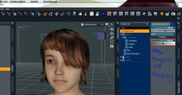

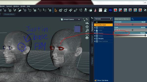

    Then,, now I finish to test,, projection template morph, in ds 4.6
    I make new morph which mix justin shape, and genesis eyelush,eyeround shape by blender,,
    and load the shape by morph lorder, then save it as usuall way. name it as FBMnewjustin,,
    next change the saved file name to FBMJustin_proj
    (edit,, apply base name FBMJustin + _proj to make projection morph) I miss typed j and J ^^;)
    then make new directory,
    in Data/daz 3d/Genesis/Base/Projection Morphs/DAZ 3D/YoungTeens
    I copy and paste FBMJustin_proj .
    I think if I change the vendor name , and product name, it seems not work.
    on the other hand when save the morph, I can choose every where. and which name I use, there seems no meaning.
    (usually,, dsf file need to keep path and file name, when we save them,,I think)
    I think I can delete original handmade morph (FBMnewjustin,,) nad simply need to keep the copied FBMJustin_proj ,,
    but I do not thes it,, (if I need to correct the shape again,,)
    and,, last pic is,, my projection morph shape.(I may not hope to use it as morph,, but to check where I change )
    eye round is original base genesis shape. but temple and mouse or other shape is justin.
    but most important place is eye lash position,,,
    then,, if you make projection morph for FBMJustin, you must make morph without body scaling.
    that means set scale to 100 then edit the shape. and import it as projection morph.
    the pic scale , I manually change scale for projection morph. (if I hope to use hte projection morph as usuall morph,
    I may set ERCas same as original justin, but there seems no meaning)
    1067 x 600 - 135K
    1036 x 553 - 88K
    1128 x 590 - 103K

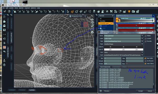

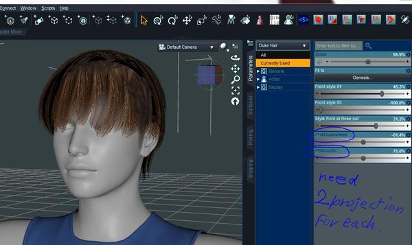

  • kitakoredazkitakoredaz Posts: 3,526
    Sorry to replay many times,, but,, as I expected,, fhe Justin head morph have same problem too. ^^;
    (and if some other user want to make projection morph someday,, hope to be useful,,)
    When FBM have problem, FHM have same problem about head part,, as for genesis1
    without it,, it cause another problem, when mixing morphs,,)
    After all, even though making projection morph for full FBMJustin,
    you may need to make Justin Head morph too. (FHMJustinHead labelled Justin Head)
    Usually FHM should be made from FBM (about genesis1) and remove morph effect about under head parts only.
    but how adjust around neck part shape then joint smoothly , genesis base shape with character head,
    seems depend on vendors.
    So that,, To make good projection for FHM , it better make from your FBMJustin projection too.
    and mix it with under head parts of Vendor head morph to keep original FHM neck shape.
    (it should be different with genesis base shape neck)
    so that when you minus FHM (head morph) with FBM, each projection morphs work correctly .
    and if DAZ forgive me, I hope to offer these projection morphs of justin for user,,
    but DAZ may not,,(it is usuall) ,, so that sorry just say how to what we can,, @@;
    1024 x 610 - 97K
