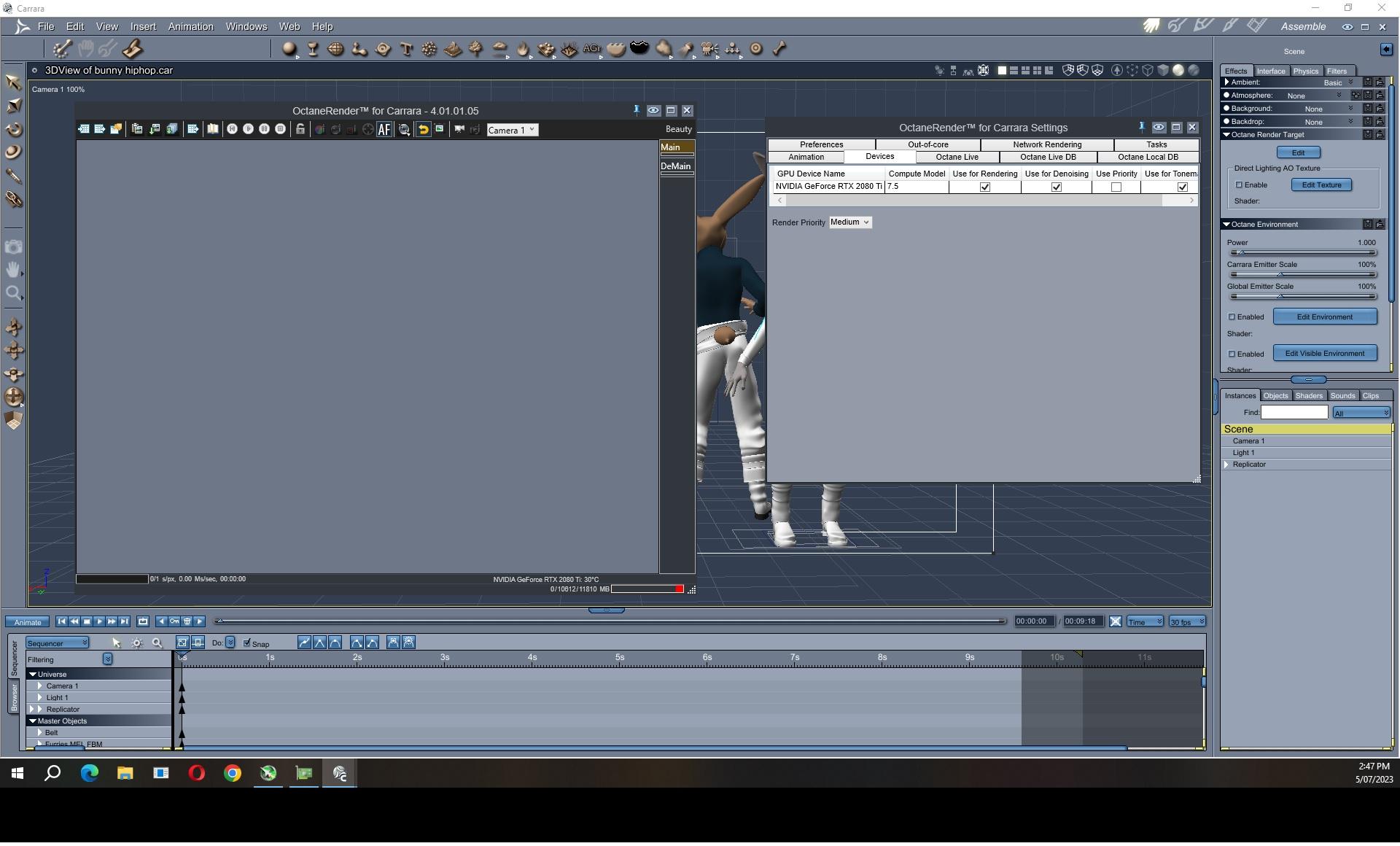

    and here I am
    it loads and all 3 versions in my downloads tried,
    is the oldest V4, no more left
    other 2 later ones worked but options greyed out as Enterprise
    it just doesn't render, all the options are there
    and yes, new C drive, mine failed, reinstalling stuff has been a nightmare
    1920 x 1160 - 366K
  • WendyLuvsCatzWendyLuvsCatz Posts: 41,752
    edited July 2023

    yeah maybe it's the driver, but I need the laest for everything else
    I guess it's the end of the line for me and Octane, not pouring anymore money in, Carrara native render is beautiful just takes a tad longer if I want PBR and/or complex scenes
    submitted a ticket to Otoy anyway
    it's the Mimic Plugin
    edited July 2023
    it's OK, it's working now, it was the Mimic plugin
    but the disabled download for the standalone still needed addressing as I sometimes use that too so glad that was fixed
    as to did I change anything? my whole C drive, got a new SSD one installed because my HDD stopped booting up and had to reinstall all my programs from scratch, still many to go...
    have the beta installed for plugin clashes as others clash with others, Mimic is installed on that and no Octane (there only can be one)
