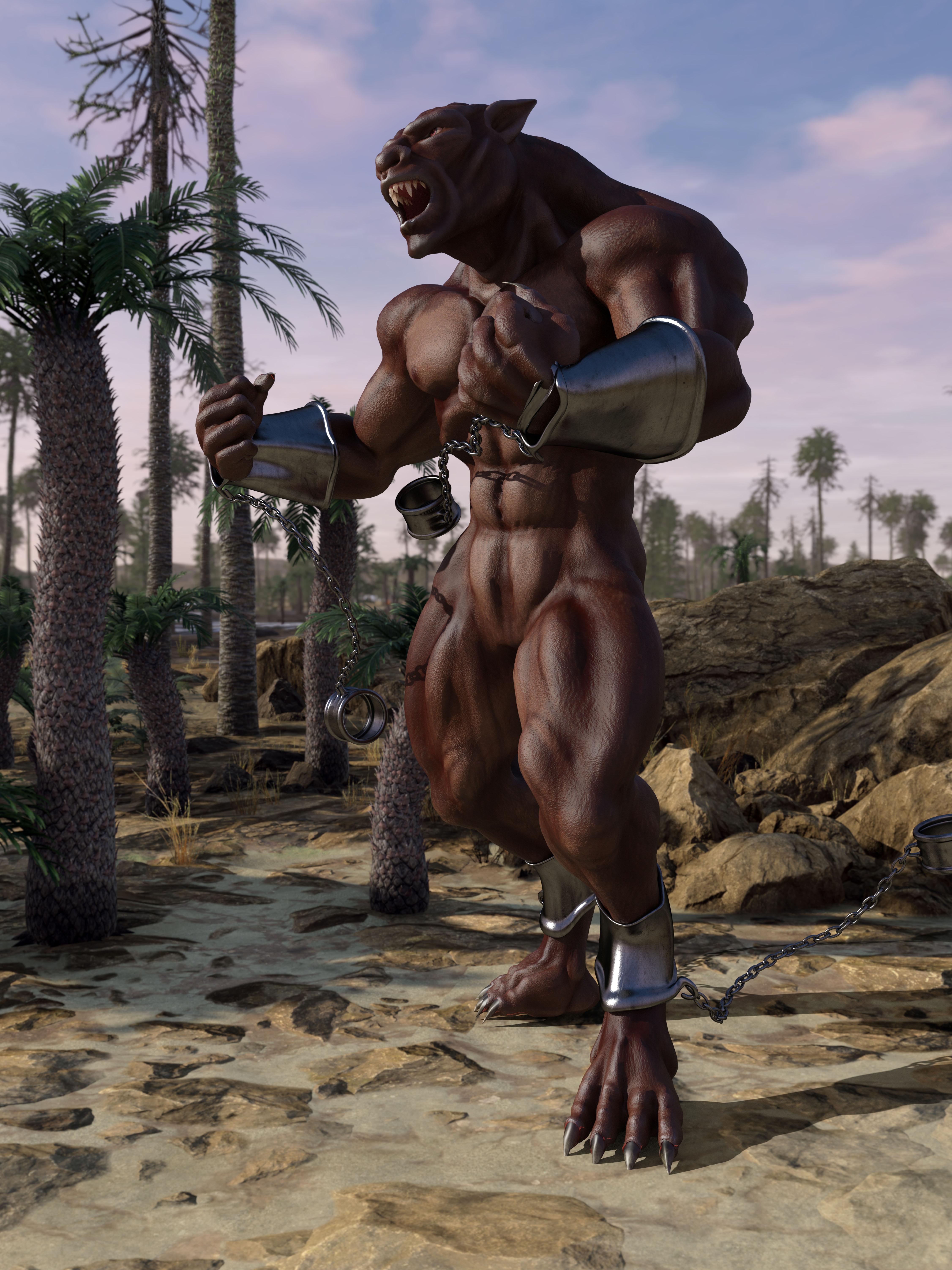

    I also can't seem to make the feet touch the ground even if i adjust the y translate in the parameters tab. Any suggestions? thanks

  • Richard HaseltineRichard Haseltine Posts: 111,842
    Have you played around with the ground settings in the environment panel?
  • SzarkSzark Posts: 10,634
    for the other issue of touching the ground > Render settings > Environment > Set ground to manual and move the object/s down to meet the ground. Best done with Iray rendering in the viewport

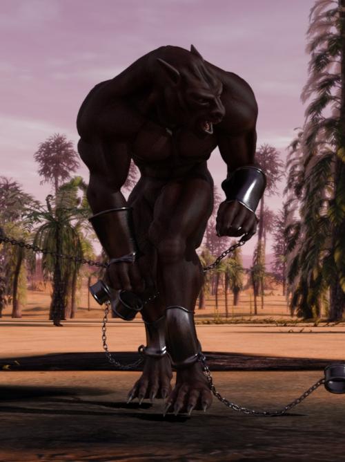

    Thanks Szark, I was able to make the feet touch the ground.

  • Avid RendererAvid Renderer Posts: 1,218
    My HDRI is so pixelated, as if low res. The render aspect is already low. I am not sure if tweaking the tone mapping settings will help. Any suggestions?
    sweet as for the HDRI being a little blurry well the size is okish, best if it was twice the size but from looking at it I would say it isn't a HDRI done with photographs but probably and rendered image made into a HDRI which generally won't be as sharp and crisp as photos in my experience. I am only guessing as you haven't provided a link to where you got the HDRI from. smiley
    edited July 2019
    So this is the high res HDRI 16000 x 8000. I must be doing something wrong because it looks so blurry, but my character is crisp. The feet is touching the ground.

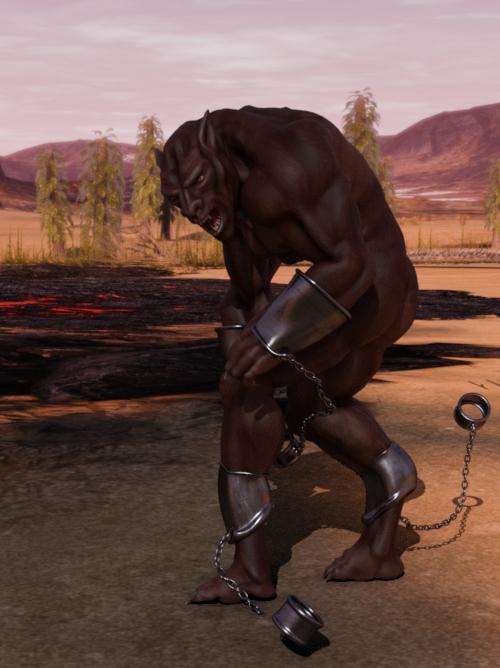

    Another thing you can try is setting the Environment Resolution up to say 4096 go to Render Settings Pane > Environment > Environment Lighting Resolution (2 channels below Draw Dome) And to be honest I don't think you are doing anything wrong per se
    edited July 2019
    So here it is: mitchel filter applied and env resol lighting up to 4096. No difference, still blurry environment but crispy character with feet touching the ground. I am beginning to conclude that this is not a good HDRI to use.
    that would be my conclusion too given everything you have tried already.

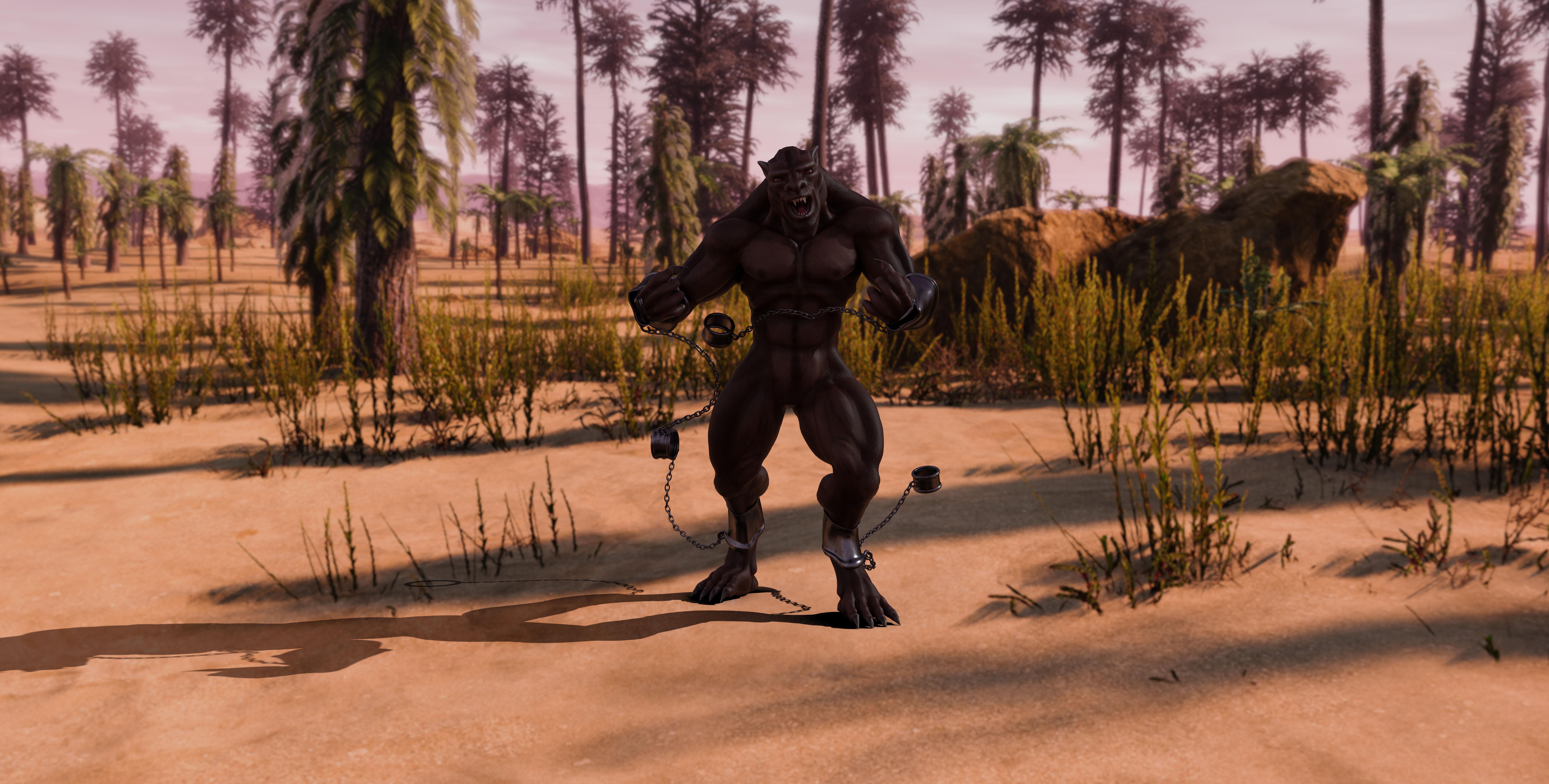

    edited July 2019
    Did you have DoF enabled on your camera? If so, try turing it off.
    I thought about that but from the looks it would have to be pretty low dof (higher than 22) for that tiny amount of DOF so I didn't mention it, but a valid q nevertheless
    edited July 2019
    Here is another attempt. DOF is completely off. I would think that the ground closes to the camera should be clear even if the DOF is on.
    Actually I'm not sure about this. In theory using a camera in real life always introduces a degree of DoF while when doing a render you can disable DoF alltogether, which should yield a perfectly sharp picture. Maybe I'm missing something, definitely not an expert on making HDRIs:)
    Ok so in that case it's the HDRI being a bit blurry.
