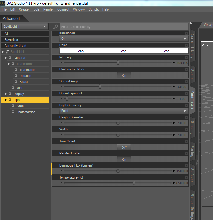

    @bradassociates "Are some of the Daz environments only renderable in 3Delight, or am I missing something?"
    Older models predate Iray and the lighting may not convert well. Old models with a skydome will block the Default HDRI.
    If you can't find lumens in the light menu, it's probably a 3DL light.
    Here's what you should see with the light selected.
    709 x 732 - 72K
    The thing to look for is the "Photometric Mode" switch seen in your screenshot. This should automatically be on if your render mode is set to Iray, but it's always best to make sure.
    Note that only the default light types (point, spot and distant) will auto-switch like this. Other light types you can buy in the store, e.g. the AoA Uber lights, will only work in 3Delight rendering, they don't work in Iray.
