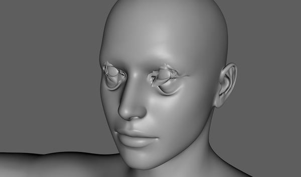

Greetings! I just downloaded the latest Studio release (4.6.1.33) and now whenever I use the "Eyes Closed" pose on any of my Genesis 1 figures, I get a freaky distortion of the morph. Am I the only one experiencing this? Is there a way to fix it or do my characters just have to stay awake from now on?

    That looks as if the limits have somehow been turned off on the actual eye close morphs - which are hidden properties on the root Genesis. Have you edited the settings, as far as you know?

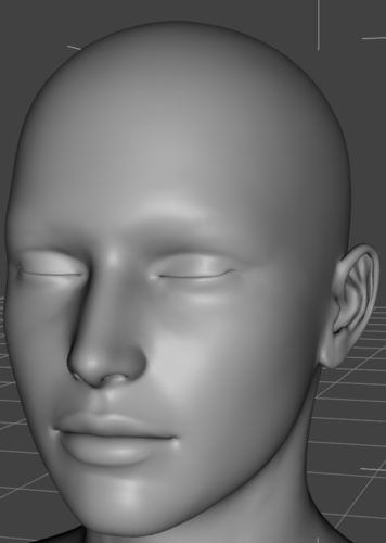

    Something has definitely gone wrong with the model. I just tested the Genesis 1 in DS4.6.1.33 and it works on my PC.
    EDIT: Parameters Tab Mini menu set to Show Hidden.
    553 x 777 - 208K

    See! Jaderail's Genesis looks so happy and peaceful! My guy looks like he just took some bad LSD!
