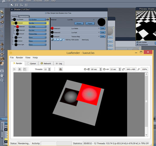

    One thing that I haven't figured out yet is how to use alpha maps/transparencies with Lux materials. I have a whole host of clothing I would love to use Lux cloth for, but need to be able to use alpha maps to make it work. Anyone know how to do this?
    Use a mix material. Plug your normal material into the first channel. Plug a null material into the second channel. Plug a normal texture map into the amount channel.
    Thank you very much, that was a very useful tip! Seems to work well, although I do have to invert the color of my alphamaps to get the right parts invisible :) Thanks SphericLabs

    Put the null material into the first slot and the other material into the second slot.
