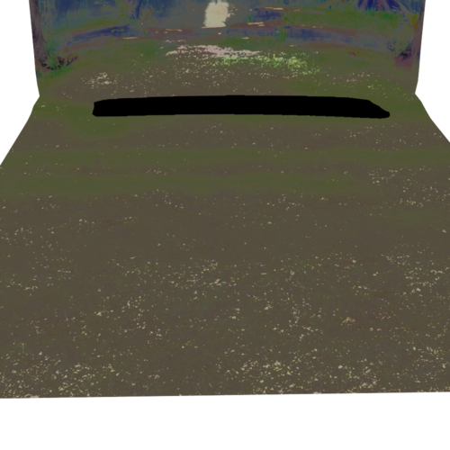

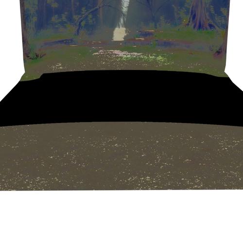

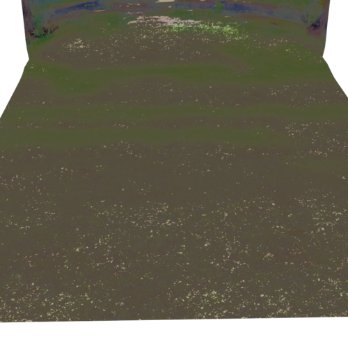

I was trying do a Cartoon Render of a background prop in DAZ 4.6 using the 3Delight option and I noticed a black area would appear depending on the angle of the prop. Is there something I can do in the Advanced setting or lighting to remove it? I've tried placing spotlights in the area but it doesn't seem to work.
Any help would be appreciated!

This is a known flaw, surfaces that are close to parallel to the camera view will appear black. There are a number of toon shaders that gives better control and results than the built toon render.
Ah ok. I guess I'll look at the other shaders. I kind of liked the default one but I already have PWToon.
Thank you very much!
