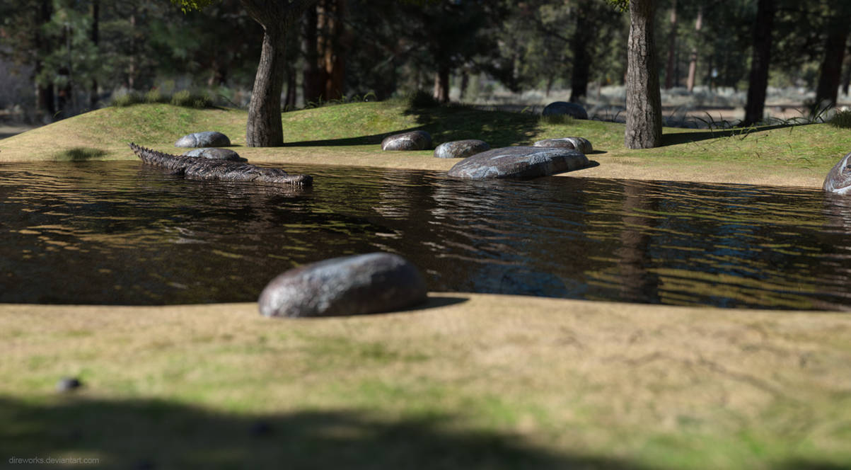

i noticed that an old 4.10 water shader i made, wont work in 4.11 with normal amd bump maps if i set refraction index and weight to 1.0, thats an old render
water shader
but now the water its completely flat, if i not adjust the refraction values
as i know there are a lot of changes in the render panel, new option and, as i feel (im not that technical so maybe i am wrong), also some changes in default render settings
anyway, awesome update! :)

    Plase report this, via a Techncial Support ticket. I didn't notice the move from 4.10 to 4.11 as being the cause but others have reproted seeing a marked chaneg in bump/normal behaviour and certainly I am seeing a lack of relief in soem cases (turning up the bump value in the Iray Uber base, I can't recall its label, does help). You might also want to look at docs.daz3d.com/doku.php/public/software/dazstudio/4/change_log_4_11_0_91

    setting a 0.9 value, on both index and weight will give a better result, not sure if i can get the same result as the render, i will check before sending the ticket,

    I experimented a bit, its not about the refraction index and weight levels properly but from glossines
    so:
    with share glossy imputs ON
    glossy roughness slightly >0 bump is working
    if share glossy imput is OFF
    if glossy or rfraction roughness is >0 bump wont work
    all of this with refraction index and weight set to maximum
