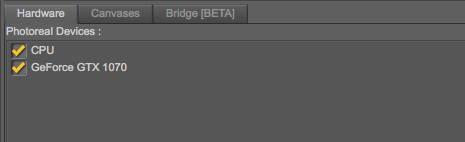

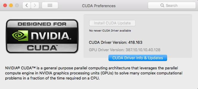

    I run latest 4.11 with these drivers and Cuda:
    665 x 440 - 40K
    666 x 299 - 44K
    465 x 142 - 12K
    Post edited by Totte on

  • TotteTotte Posts: 15,207
    I updated within the Cuda Control panel to the latest before the scree shot, there is a new one every week it feels like. I hadn't run DS for a few days, at the cottage, so I had to VC back to my machine to take the screen shots as I have no nVidia card in this machine, yet.

    Step 10: This is where I got stuck and this is where Totte helped me out with the last part. I had everything working but DAZ 3D did not recoginze my NVIDIA card! In order to fix the last step, you need to install the CUDA drivers, as Totte said here:
    Totte said:
    You have a CUDA Update, did you install cuda: https://www.nvidia.com/object/macosx-cuda-418.105-driver.html
    Download the CUDA drivers and run the install. When the CUDA installation is done, reboot your Mac (if your Mac does not support a cold plug make sure to unplug your eGPU before booting up!). Once you rebooted, the following screen will pop-up:
    Also, on the top right corner the NVIDIA drivers panel will pop up and say the following:
    For me this does not make a difference. I start DAZ 3D and BOOM my Nvidia card is there:
