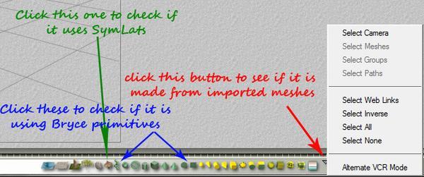

    I made this screen shot to answer another question, but it does show you where to click to select different objects in the working screen
    Each of the icons along the bottom will bring up a list and you can select the one you want form that.
    It is quite possible that your river is made form a plane or water volume, that is the last two icons at the left. The next one along is the terrains.
    600 x 251 - 61K
