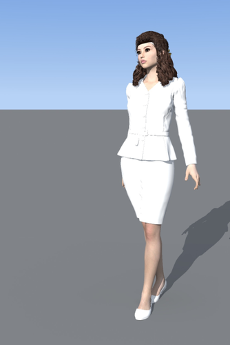

    The input is SO appreciated. I think the export dialogue boxes have changed a bit in 4.6 on a mac so there are no checkboxes for morphs and skinning but with those concepts I was able to export a pose with the right colors etc. Here is the quick render of my cusccess. I am still trying to figure out the scale of the image maps for the eyes to avoid that zombie look. I guess FBX is next. Thanks for helping an uninitiated member!

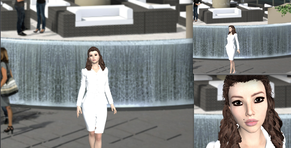

    The thing with the eyes is a lack of an alpha image map, or trans (as in transparency) map. It's a black and white image map which defines opaque and clear areas. Shades of gray define partially clear areas. I don't think a .mtl file contains all the texture information, such as alphas. Just the basics like the texture maps that define color and maybe bump. If you have the image maps for the alphas and specular effects, you should be able to load those maps into the appropriate shader channel in your rendering program.
    Personally, I prefer Carrara's renderer. It's fast and versatile. There's also a Lux plugin that you can use to convert your scene to render in Lux Render or something. No need to export .obj files as far as I know.

    Thats interesting EP, thanks; I was trying .pngs with a transparent background to no avail.
    Dbat i hope to be helpful once I get into the program more. This forum has already been an encouragement. I am primarily working in DS to create the "talent" and then bringing them into my more complex models. This is already showing promise (and its fun) so I look forward to hearing everyones continued input in the future. If you're interested my company is at mediaportfolio.org. Thanks!
    1329 x 678 - 1M
    What software are you using to render your figures in?
  • mediarchitectmediarchitect Posts: 5
    Using Artlantis 5 since my company does a lot of architectural rendering. Since it has a really intuitive interface I also use it to do some of our media work for corporate clients. I have DS and poser but have yet to make either one of them part of our workflow. I am optimistic with the new 4.6 in combination with Artlantis.
    I was curious. This is the Carrara forum, so I'm used to Carrara-centric users. The discussion is still relevant, so I wouldn't worry about the forum. I was just a little confused is all. It's a state I find myself in more as I age. ;-)
    So, in Artlantis, do you have access to multi-channel or complex shaders? If so, you can fix the eyelash thing by looking for the transparency maps in your Textures folder and loading it into Artlantis. The UVs and shading domains for the figure should be intact on the .obj, but I don't know about the domain names. If they are intact, look for thee eyelashes domain and try and load the eyelashes alpha map into an alpha or transparency slot/channel. If that makes sense. ;-)
