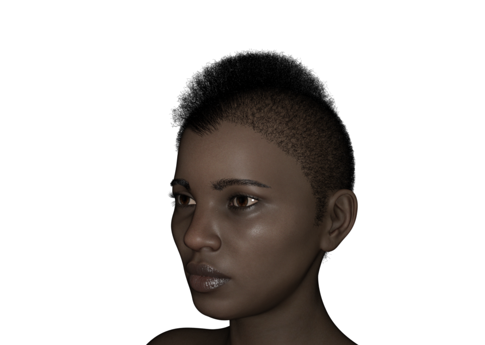

I just installed 4.11 and everything is fine except one thing: some surfaces gets distorted. It's NOT about the denoiser, I have tested with and without.
I have a render made with 4.10 of a character with the skin of Makayla (https://www.daz3d.com/makayla-hd-for-genesis-8-female ). The lips looks just like in the promo pictures, they have a slight metallic shimmer. But when I render the same picture (the same file = the exact same conditions) with 4.11, that shimmer is gone and the lips are just flat. As I said; its the same with and without denoiser.
Is there a setting that has to be changed in 4.11 or is it a bug?
Uploading of pics failed but I have included links below.
Makayla skin rendered with 4.10
https://postimg.cc/tnqpBr12
https://i.postimg.cc/yx9xYt74/Makayla-Lips-4-10.jpg
Makayla skin rendered with 4.11 without denoiser
https://postimg.cc/rzMVyphx
https://i.postimg.cc/tRVY5ZWS/Makayla-Lips-4-11-NO-Denoiser.jpg
Makayla skin rendered with 4.11 with denoiser
https://postimg.cc/9Rtct3fD
https://i.postimg.cc/HxFjmdD9/Makayla-Lips-4-11-WITH-Denoiser.jpg

    The thing is that one of the pictures is from a set that where rendered with 4.10, and happened to look eactly is in the promo and I was happy with that. After I updated to 4.11, I used the same character and skin and couldn't understand why the lips where flat. One of the things I did was to re-render an older pic with 4.11, a pic that I knew had the lips working fine. Thats the result you see. The pictures you see has the eact same lighing etc etc, it is the exact same file just re-rendered with a few days between. There is no other changes than an update of Daz from 4.10 to 4.11. So there is "proof" that the lips looks different, the problem is why?

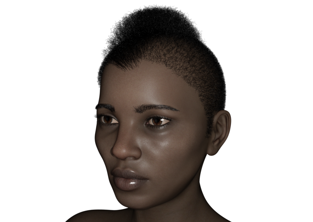

    Try changing the dual lobe specular ratio. Here's the default setting:
    And here it is at 100%:
    996 x 708 - 405K
    996 x 708 - 323K
    Post edited by Gordig on
    Fantastic! You are right, that worked!
    Any idea why the setting is needed in 4.11 but not 4.10?
    Thanks for the help!
    Btw, it was a good setting to know aboout. I have tried it on other lips and it very often gives a nice effect!
  • GordigGordig Posts: 10,805
    edited July 2019
    After I did those renders, I tried the same setting on the skin, and that looked better too, so I may just reflexively crank it to 100% on everything from here in out. As for why it’s needed now, I have no idea. I’m not too well-versed on texturing at this point, so I basically just brute-force settings until I get more or less what I want.
