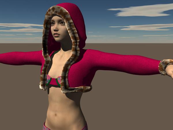

Hi there,
just purchased this: http://www.daz3d.com/hoodie-and-hot-pants-set ,
gave it a real Fur in Carrara and got this:
2000 x 1500 - 183K
  • DartanbeckDartanbeck Posts: 22,156
    Very cool! Nice job on the dyno-fur!
  • EddyMI3DEddyMI3D Posts: 365
    Thank you DB. I just was curious if it would work in Carrara, but I think the Carrara Fur looks even better ;-)

    One thing to note with cararra fur, is it's dependant on surface normals (or it seems to be). I've noticed a few products that turn out wonky till you make sure all the normals face outwards. There's a set from Rendo called BC that has a lot of inverted polys that aren't noticeable in render, but do create problems when you add fur. I mentioned that one because it does use displacement maps for fur that look fine, but cararra fur looks fugly till it's fixed.
