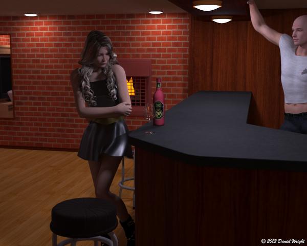

    What type of light effect are you trying to achieve, If its interior lighting then the best way to go is by creating mesh lights, which is taking an object and adding the luxus/luxrender light settings to it.
    To do this 1st make sure you are on the surfaces tab, then select the surface that you wish to make into a light source (see the 3rd image)
    next click on the little menu icon and select Luxus - LuxRender Material (see the 5th image),
    next select Material Type - Matt, put a check mark in Light Parameters and Copy Studio Parameters then click on Accept (see the 4th image)
    then scroll down to the luxRender settings and turn LuxRender Light - Enable to ON, just below that you can set the colour of the light (see 2nd image).
    Take a look at the 1st image, all lighting was done in this way,
    Hope this is of some help.
    (sorry the images are in the wrong order but thats how they seemed to be uploaded)

    Wowzers thanks for the all the help! I was stuck on this issue for the longest
    Platnumk this method is exactly what I was looking for, I cannot thank enough. W00t w00t my gears are unclogged, and now my machine is moving! Thank you my friend!!! :D
