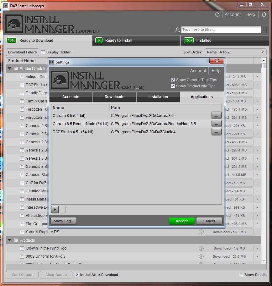

    Do you have Carrara listed in your DIM settings?
    Settings are accessed from the little gear on the top right.
    868 x 910 - 130K

  • StezzaStezza Posts: 9,299
    what version of DS are you using..
    I find to reinstall smart content on Carrara firstly I have to instal an early version of DS like 4.0 .. anything later for me does NOT work.. then setup smart content in DS.. then instal Carrara and database conversion files so to show all the content in Carrara Smart Content tab.. this process depending on how much content you have will take a bit of time to do the conversion.
    If it happens instantly it probably didn't work.
    It's a PITA but is DAZ3d fault for not keeping Carrara updated .  angry
  • chickenmanchickenman Posts: 1,202
    I haved also found that you cant have DIM open or DZ open at the same time as Carrara or it will not see the Smart content.
    Some times I have had to use Studio and reimport the metadata and then close Studio then start Carrara before it would work.

  • 3drendero3drendero Posts: 2,037
    DS 4.8 or older is needed for a fresh setup or if you reset the database yourself. Then you get a copy of the old SC database format for Carrara.
  • SileneUKSileneUK Posts: 1,980
    Which version of DS are you using.   I had trouble getting Smart Content to show back when 4.10 came out, so I rolled back to 4.8 (which I'd kept as a download) and use that for my Carrara linked content. I run 4.10 public beta along side it for other features needed in DS.  I think some others got around the problem differently and don't do as I did. Maybe they can help get it all to show up.  Do check your DIM settings
