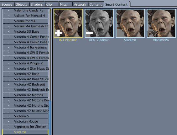

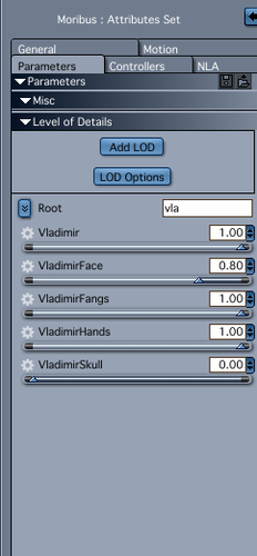

    Here is Vladimir rendered in Carrara 8.5. The textures are my own. The screen shots show how it appears in the browser and that morphs that get installed when you inject them.

    OK, many thanks. I have used Carrara quite a bit, but this is new ground for me. I went ahead and bought "Vladimir" since it was 65% off and I now know its possible to get it into Carrara. I searched a little for the batch file @ DAZ and Google, didn't find it, and it did not come with Vladimir. Something in the Forums made it look like its in the "Runtime/Libraries/!DAZ" folder, which for me is the Poser 7 runtime which I link in Carrara's browser (that's also where I load M4 from). So I'll look there (not on this machine).
