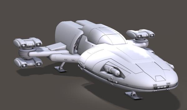

    And, as a preview of the "item"....
    1387 x 821 - 220K
