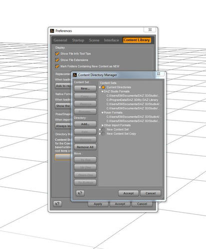

    Also my Content Directory Manager is not looking like Jaderails example
    790 x 762 - 103K
    Where is your content installed to?
    You need to put in the path to the folder that holds your DAZ content. Your paths all finish with Studio/ or Studio4/, they should be My Library if you installed the content yourself, and My DAZ 3D Library if you used DIM. How did you install your content, DIM or by hand yourself?
    Did you uninstall the CMS from the Start menu? From a previous post by me:
    Go to Start > All Programs > DAZ 3D and try to start CMS from there. If it still causes problems, you may need to uninstall CMS (from the same place) and then reinstall DAZ Studio to get the latest version of CMS.
    Did you do that? You MUST uninstall CMS first, then reinstall DAZ Studio. If you are not sure what to do, please ask.

    It must be where I'm directing my content to?
    Sorry feel like a total knucklehead.
    Hitting accept,apply then accept
