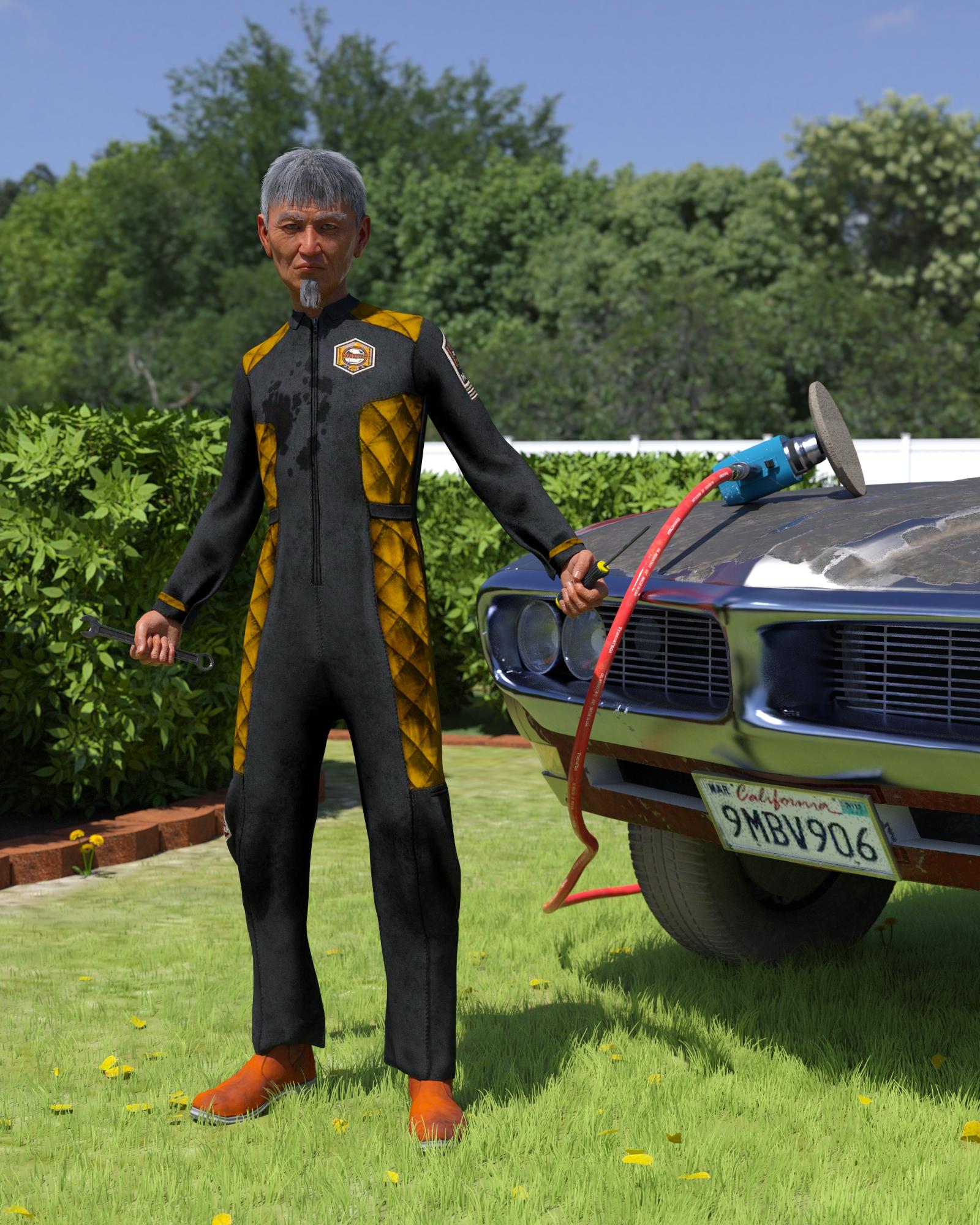

    I bumbled around and loaded one of the presets. I raised the character up and did an animated dForce simulation of lowering him onto the grass. Why is the grass poking through his shoes? Did I do it wrong?

    No, I don't believe that is necessary. dForce collides with visible objects, unless you disable Visible in Simulation on the object or on a specific surface of the object. Applying dForce Static Surface modifier is useful if you want to control the dForce friction on the object. I have never had to apply dForce Static Surface modifier to any object used for collision with clothing.
    By default the grass has a collision factor of 1.5 which seems pretty large. I reduced that a lot and got better collision performance. However, in the very edge, I still got some poke through.
    I thought I had a brilliant idea. I added a geometry shell with a mesh offset for A Touch of Dirt, so I thought I could collide with that, but it didn't work. Maybe geometry shells don't work as dForce collision items. I moved on and did not investigate that problem any more.
    Eventually I got something "good enough".
    1600 x 2000 - 2M
