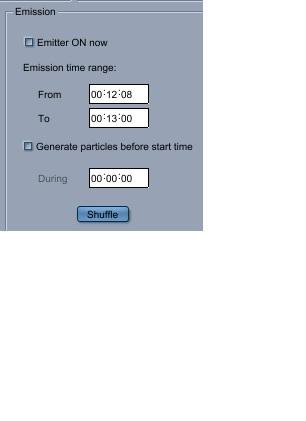

2) I set the particle display to "None" for all particle emitters.
3) I checked "No calculation in 3D View" for all particle emitters.
4) I unchecked the "Emitter ON Now" in the modeller room for all particle emitters.
5) I made sure the Start Time is after the timeframe I am working with for all particle emitters.

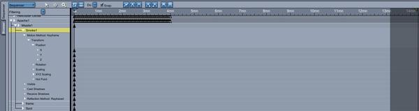

    I checked again to make sure no keyframes exist for the emitters for the first 12 minutes. See screenshot below. The emitters remain unchecked through the entire first 12 minutes. I also checked under the "Master Objects" section of the sequencer.

    I'm kind of wondering if the time frame in the emitter that you posted isn't in seconds and frames? So maybe 12 seconds and 8 frames?
    I believe that I misinterpreted the ":xx:yy:zz" to be hours/minutes/seconds, and I think now it is minutes/seconds/frames. So I changed the From and To values to be +12 minutes and +13 minutes.
    I got the same results - Carrara still is attempting to calculate particle animation.

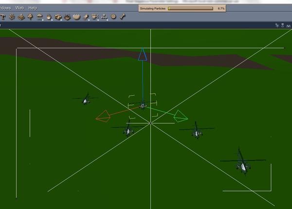

    Thanks, Fenric, for the suggestion. I set all 40 emitters' "Particles displayed in 3dView" to zero.... Same result. It took 3 minutes to simulate particles for a test render... (Screenshot below)
    I guess chasing some solutions only leads one up blind alleys. :smirk:
