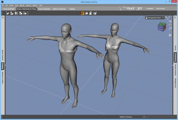

Load in the meshes, both the base and the V5 one for comparison: 01RawMeshes.jpg

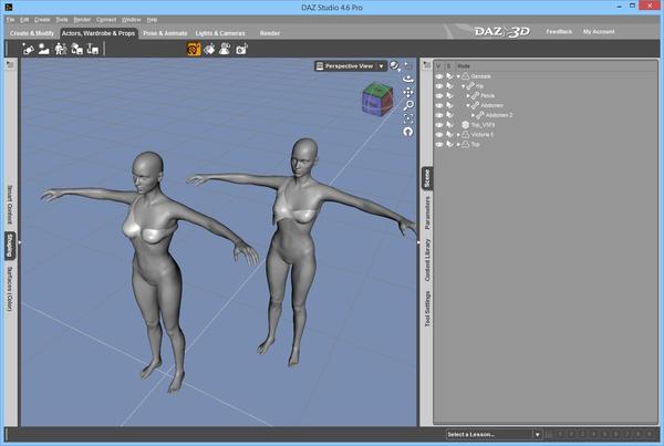

add the V5 morph to the genesis figure, and the top morphs along with it in an expected way (looks ok, but needs tweaking): 03GenesisMorphed.jpg

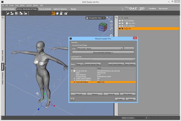

Use the Morph Loader Pro to load in the replacement deltas for the V5 morph for the top: 04MorphLoaderProSettings.jpg

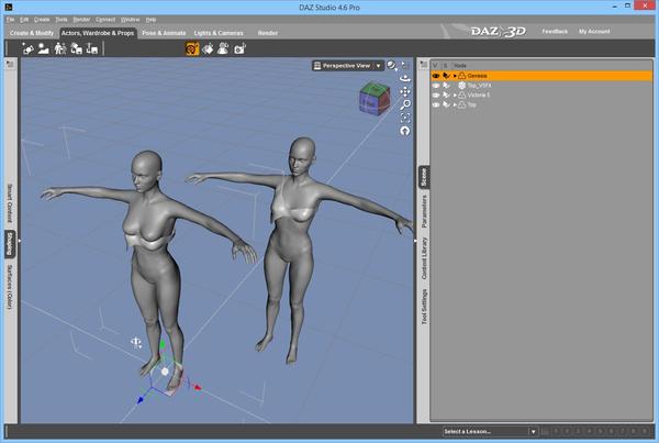

Aaaaaand the result: 05MorphLoaderProResult.jpg
Attempting to transfer the tweaked mesh to V5 directly has the same result (with the V5 figure having the applicable morph noted)

    Did you set scaling on V5 to 100% before starting the modeling and subsequently the conformation process? It needs to be at 100 to work properly and needs to be modeled against that scale.
  • The_Grand_UserThe_Grand_User Posts: 0
    Ah, I did not, I shall attempt that.
    It seems to have worked, thank you very much :)
